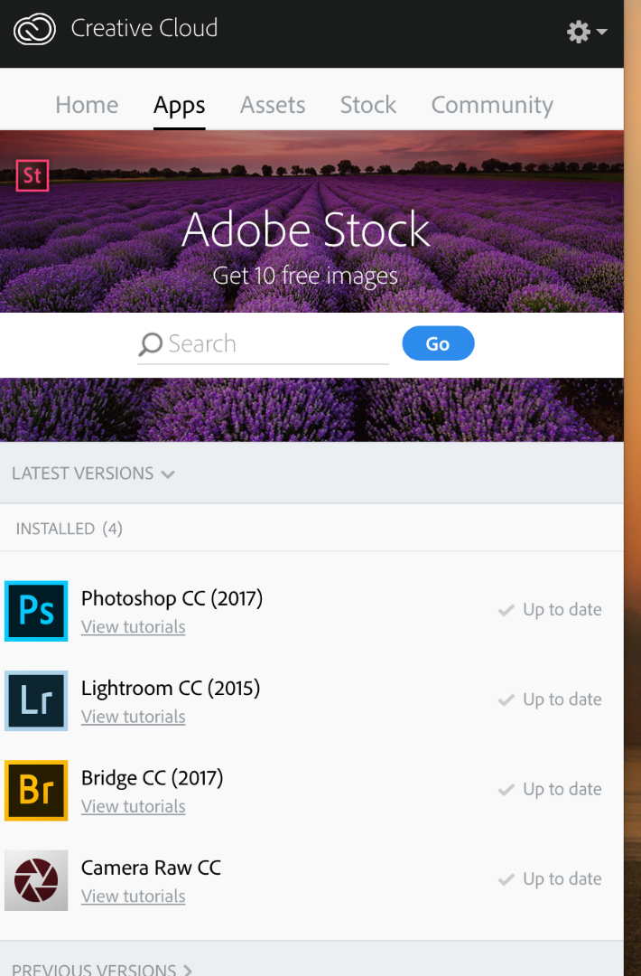

Copied
So over night I have formatted my imac, and re installed el capitan, downloaded and re installed PS, LR & Br, signed in signed out shook it all about... & I am still only showing 2015 in LR.
PS shows Version 2017.0.1, lightroom shows 2015.
Downloaded the patch installer and it shows the same thing, Update failed, contact Admin !
Have been into the firewall & made exceptions to let PS< LR & BR through, still the same !
WHAT is going on here ? PS & BR seem to be up to date but not LR !
Confused !!!
