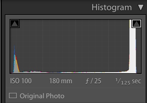

Hi
I have been doing the following in Photoshop, but it can be done in Lightroom as well.
Here is a histogram of a photo I took against a white background before I start processing it:
Note that I have selected the triangle at the white end of histogram.
Now I go to the Tone Curve and grab the curve until all the "near white" points are actually white. Because I selected the triangle above, Lightroom gives me feedback by showing the points that hit pure white by making them red in the image.
Once you get the whites where you want them, then bend the tone curve back to linear for most of its range. This will put about 90% of the tones where you want them (depending on how many highlights you have in the image).
Now you can fine-tune the tone curve and make additional edits.
I prefer doing this in Photoshop because of the additional control it offers, but depending on your image, this should work fine in Lightroom.
And, BTW, I think you do want your "white" background to come in around (250, 250, 250) and then move it to (255, 255, 255) in Lightroom -- the brighter your background is, the more glare and other artifacts you'll suffer from. It is easier to get it "close" in the camera and fix the last bits in Lightroom.
Oh, and be careful using the exposure controls in Lightroom -- these will move the whites as well as the image. If you just use the tone curve, you can be sure that your whites remain pinned at (255, 255, 255).
A
