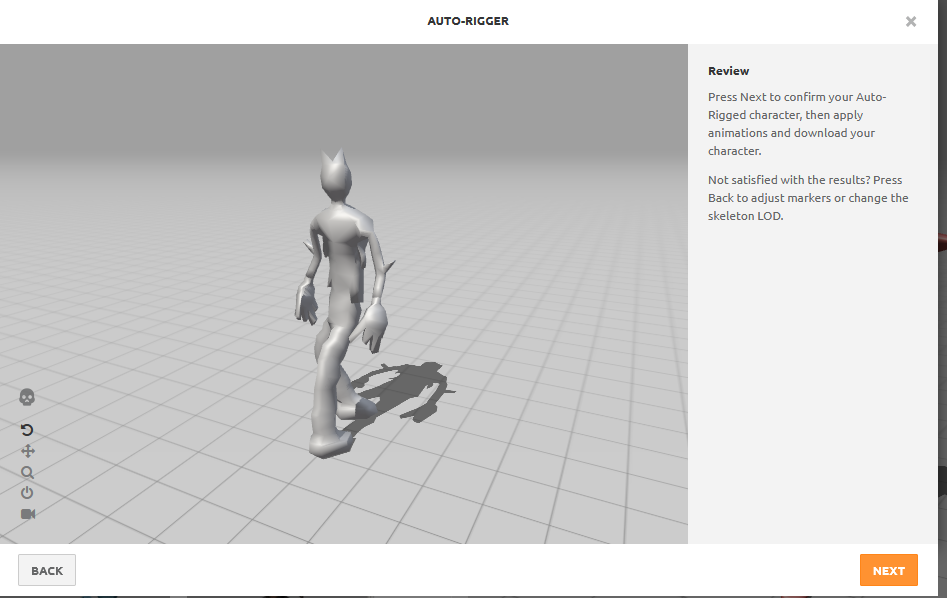

LEGEND ,
Mar 12, 2021 Mar 12, 2021
works ok at my end... I'd try using a different browser

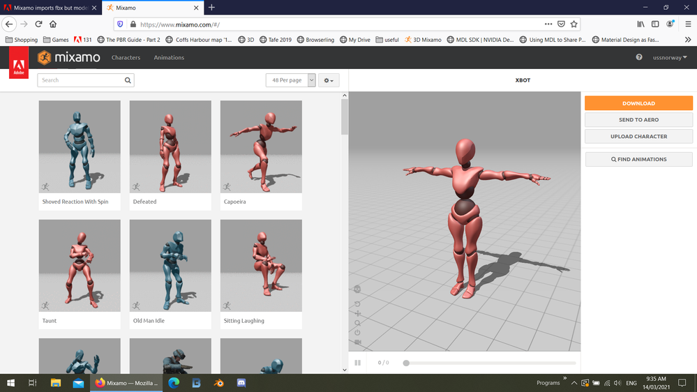

LEGEND ,
Mar 13, 2021 Mar 13, 2021
to use Mixamo you have to sign in
to see images you have to download them from www.Mixamo.com
to load those images and animations on the webpage your system has to allow access to a temp folder on the local drive
test 1 = load Mixamo, sign in and take \ post a screenshot... if all the little animations are there then your browser is working
we know Mixamo is working and we know that Fbx model will load so imo test 2 is to try using a mates computer to upload the model... in the end this will be a proxy server or antivirus trying to be helpful but set up wrong

LEGEND ,
Mar 14, 2021 Mar 14, 2021
yes Mixamo does use webgl
test 1 = try animating your thumbnails
yes Ubuntu can have issues with webgl because tracking software assumes Windows or Mac and Ubuntu is really a tool for people that know code... anyway good luck
https://www.binarytides.com/enable-webgl-firefox-ubuntu/
