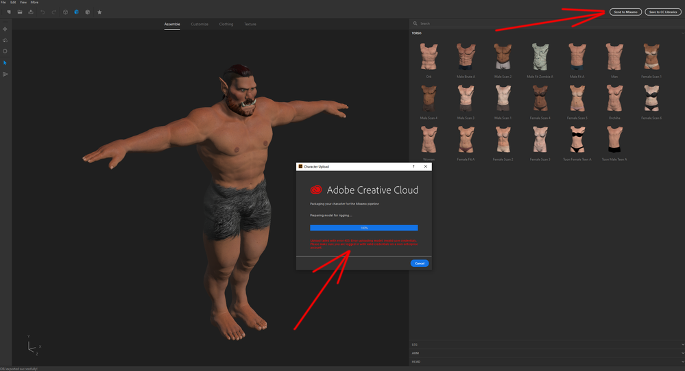

your model will not upload from Fuse to Mixamo because Adobe pulled the plug out of the wall and shut their server down
2nd the chin you uploaded to Mixamo in your second screengrab has been distorted by whatever software you used on the Obj Fuse exported out... was it Photoshop, Blender or Maya?
the Fuse model will have teeth as a different part inside the mouth and with a jaw \ mandible that big I would use Wrap but other software can do the job if you are ok with stretched textures..

1st
the Fuse model will have teeth as a different part inside the mouth and with a jaw \ mandible that big I would use Wrap but other software can do the job if you are ok with stretched textures... anyway yes it can be fixed but it helps to know what engine because Unity has its own issues
is it worth still buying outfits for Fuse = yes I think so and have many of the ones Steve (Arteria) makes + Holly https://cutsceneartist.com/ is probably the best person to talk to about getting Fuse to play nice with Unity however Adobe also changed their Mixamo file types so be careful following old tutorials with Fbx file types
p.s, I see from your screengrab that you still have the old build of Fuse and the old Creative cloud app so I assume some sort of school system? Warning... DON'T UPGRADE your CC APP! it will kill Fuse from booting up
