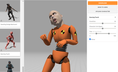

I uploaded a character to mixamo https://www.mixamo.com/#/ that has 6 textures embedded into the FBX. The output looks good as seen in the screenshot below but when I click download Collada, it's only downloaded with 1 texture in textures file.
Since the texture is that of the tongue, the output in Blender looks like this:
Is this a Mixamo website bug or is there anything I can do to fix this? What is the reasoning for this result? It randomly picked out the tongue texture.

LEGEND , Jan 11, 2025 Jan 11, 2025
baking the textures will be the fix but the problem was caused by your converting to Collada
Mixamo is a rigging software not a file converter... but as you figgured out baking the textures together works around it

So I'm assuming multiple texturres is not supported on this site so I ended up baking the textures into one using this method
LEGEND ,
