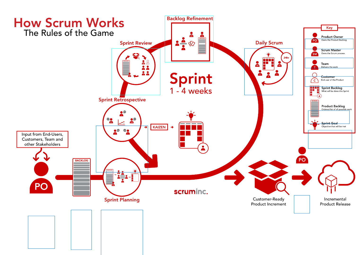

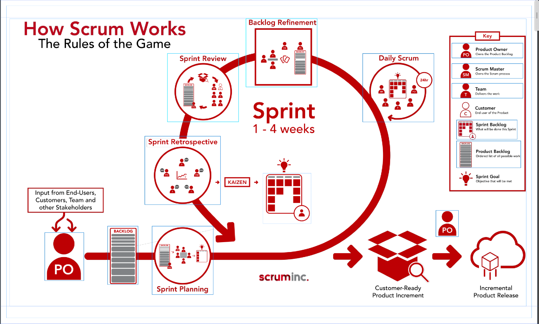

Hey everyone,
I've attached two photos. The setup is one background image, with invisible boxes on top of key areas to replicate an clickable link. One has all the clickable states (outlined for your visibility) on top of the appropriate areas, and they're exactly where they should be. The second is what happens when I resize it in the browser. Only the top one on the "backlog refinement" image stays anchored to the correct area.
They all have the same settings, responsive width and height.
How can I get these boxes to scale at the same proportions of the background image so it always stays aligned.
Correct -
Incorrect, resized down.

So, I think it is working correctly now! You have been not very far from the correct result!
Here is the corrected file: https://www.dropbox.com/s/qovbxy0jv3j729v/HSW-Muse_Mod.muse?dl=1
I modified only the „Home“ page. My modifications:
  1. I replaced all rectangles by empty image frames (Not really necessary, but a little more secure, because image frames only scale proportionally and rectangles can scale only in width as well. I did this to avoid errors, because all element necessarily have to scale in the same way.
  2. I re-sized the frames at a high zoom level to be sure, that they only touch each other, but definitely don’t overlap. In your layout, especially the frames in front of the „Key“ items are placed quite „carelessly“.
    • Attention: Overlapping elements can’t push down/lift up each other. That is an absolute principle of Muse.
  3. The main issue: Your top „Guiding frame“, at which all other elements are orientated, isn’t placed exactly congruent on the background image.
    I corrected this, by using the „Crop“ tool and dragging the upper edge of the image frame, until it meets the upper edge of the upper guiding frame:
  4. To make it easy to observe, that all elements now work fine, I coloured them „yellowish"
