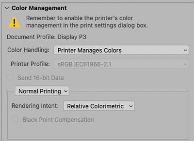

@Blumer8 Just on the off chance I'll ask
- Photoshop CAN make a printed proof (which would alter print appearance) based on the "View/Proof settings" options - IF you set the print dialog's color management section to hard proofing,
see screenshot below
For normal printing, the color management section should be set to Normal Printing (see below)
If you're not using the upper setting but selecting Normal Printing here and stillseeing that change, then MAYBE the bug is that Photoshop is making a proof when you didn't ask it to.
I hope this helps
neil barstow, colourmanagement net - adobe forum volunteer - co-author: 'getting colour right'
google "neil barstow colourmanagement" for lots of free articles on colour management

Ok, I've double checked and I am using "normal printing" in the print dialog.
I've even tried the test using a different ICC profile (one that is installed with the Canon print driver), and printed a version with the "View>Proof Colors" on & off, and the color still changes.

Nov 04, 2024 Nov 04, 2024
Monitor profile is called "HP-27xw"
Try a different profile just to rule that out. The monitor profile is involved in this equation too at some level. Manufacturer profiles are pretty often defective in different ways. In this case, looking at your original illustration, it only takes a tiny shift in the red primary to explain this change in cyan/blue.
As far as I can tell, this is a standard gamut monitor, so try to replace the profile with sRGB IEC61966-2,1. Relaunch Photoshop so it can load the new profile.
Community Beginner ,
Can the monitor profile actully effect the printed result? That seems bizzare to me.
I will give this a try tomorrow and let you know, thank you for the input!
Agree, it does seem bizarre, but then, this whole thing is bizarre. Leave no stone unturned.
As I said, it only takes a tiny nudge to the red primary to cause this change.
Nov 05, 2024 Nov 05, 2024
I've changed the monitor profile to "sRGB IEC61966-2.1" as you suggested, and reprinted the test with "Proof Colors" on & off. The difference is still there.
Also, I noticed the color is different now compared to when I had the monitor profile set to the HP setting.
Once again, I didn't think that changing the monitor profile would effect any change in my prints!proof color test.jpg
Crazy. This is not how color management is supposed to work...
One last try: In Photoshop color settings, try to change from "Adobe Color Engine" to "Apple Color Engine".
There was a color problem a while ago, otherwise unrelated, that was apparently fixed by this. I say "apparently" because it is clearly a bug; it should obviously work regardless.
Things are a little more complicated on Mac than on Windows, because the OS is directly involved in profile conversions, much more so than Windows which maintains a hands off policy leaving it to the application.
Do you have other Adobe applications you could try to print this from, like Lightroom Classic or InDesign? Just to see if the same happens there?
I will try the color engine change and let you know what happens. Why not, right?
I have InDesign, but I stopped using it last year because it too started changing the color of my printed pieces!
I was using InDesign for my print templates so I could waste less paper with some of my print orders, but sometime in 2023 or maybe late 2022 someting changed and I noticed that the color of my prints were not the same when compared to prints sent directly from PhotoShop. I think this may be directly connected to the "bug" you mentiond. I used to have my studio in a different location, and used a PC there. Now I am mac based, but, I was able to use InDesign without any problem early on. I don't know what changed.
It's not just when changing the "proof colors" setting that color has changed.
In early 2023 something changed drastically, and colors that I was always able to produce on the same printer and paper using the same ICC profiles I've been using, I can no longer create, and it is the vibrant blue/aqua hues that are being changed. The differences are much greater that what I've shown in this post
I hate to bring all this up now, but it really seems like it may be the same problem?
Back then when it happened I contacted Canon support and they of course were no help. Apple support was also no help.
It's a shame, because now my biggest art client is afraid to create her originals using some of those colors, just so I can reproduce them more accurately!
I have more information if you think it pertains, it is a lot to type out and explain.
Well, changing the color engine made a difference, and the 2 test prints with proof colors on & off now look the same!
You've helped me figure out at least part of what is going on, and I thank you!
I'm not sure if you've read through my last post yet, but once you do if you have any suggestions on how to proceed, please let me know.
I did notice that the printed color with the Apple CMM is not as saturated as it is with the Adobe ACE setting, so I've learned that I need to have the Adobe ACE setting on, and make sure that the proof colors setting is off. That way my color is closer to the control proofs I have on file for my clients.
I did read it, but I don't really have any explanations. But the problem does seem to be in MacOS.
I hate that feeling of not knowing what to trust or what is correct. This would drive me up the wall. I'm in the very fortunate position of having an absolutely perfect match between what I see on screen and what comes out of the printer.
Keep us posted if you find out more -
Nov 06, 2024 Nov 06, 2024
Thank you for your help, I can't tell you how much it is appreciated!
Like you had alluded to, this has caused me a ton of stress over the last couple years.
I've always been proud of the fact that I could absolutely nail the color of my clients art in my prints.
I have my monitor, scanner and printer all calibrated, and have created a color managed workflow that has made my process much faster and efficient.
Then this happened (whatever it was), and I had to go in to all my files and rework the color again, it was hours and hours of work, cussing and stress.
And even after all that, I still cannot produce the vibrant color that I was able to produce before, using the same paper, ICC profiles and printer!
I still find myself getting mad just typing this. Somehow something changed (probably in the macOS like you said), and now I am considering getting a windows laptop just to send files to print from, but that isn't a great solution.
Thanks again, you are the only person that I've spoken to about this problem who took the time to look onto it, and understood enough to suggest a solution.
