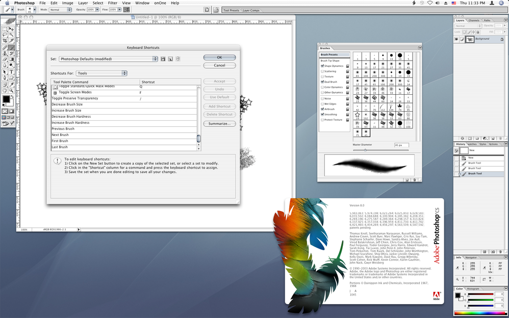

Bug or not, the issue is present all the way back to photoshop cs (photoshop version 8 the first version with changeable keyboard shortcuts) running OS X 10.4.11 Tiger on a 2001 Power Mac G4 Quicksilver .
Even Summarize  Keyboard Shortcuts says no keys are assigned, yet everything still works as though no keys had been deleted.
