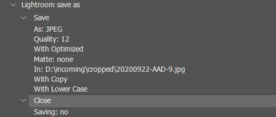

Prior to the save as change I used an action to save as and close current image which worked fine. Today when make an action to save as the action works fine except evey time except I use it it renames the file to the name of the original file used making ther action oveerwrites the existing file. Result aster using it on 20 files what I am left with is the original file name of the file used to make the action and the last file saved as the action was overwriting the same file every time it saved.

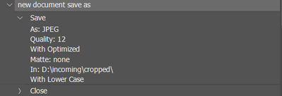

Using the new document name has the action keep only the file location and not the file name.
Is it normal to then have the action  stop on file name and options?

Hi I export from lightroom, photoshop opens new image, crop image, run action, image closes, export  new image from lightroom and repeat. The action uses the file name from when the action was made which replaces the file every time it saves. The thing is prior to the save as change in photoshop this action worked using current image file name.

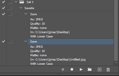

When you recoded the step you touch the File Name field in the Dialog that sets the File Name. When you do that the step will be recorded with the full path and file Name and extension like you show in your Action.
If you look at the Action I posted you will see two Save As steps. In the first Save As step just the Path is recorded into the step.  The second Save As step the Path, File Name, And Extension is recorded like your save as step because I set the File Name when I recorded  the second Save As step. Where I did not touch the File name field recording the First Save As step  just the save to folders path I set is recorded into that step.

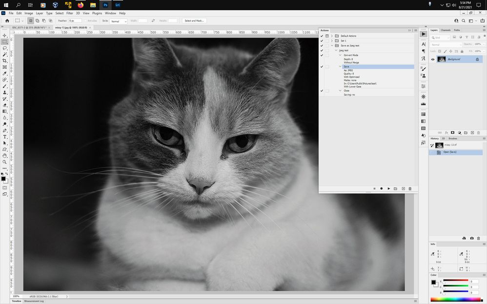

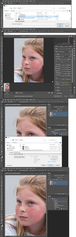

Actually this looks like a possible bug in photoshop 22.5. and/or Lightroom Classic 10.4.
If i open a camera raw file from Lightroom Classic 10.4 into photoshop 22.5 i get the same results you do trying to save a jpeg, in that is the file name is retained.
If i open a file from somewhere else using File>Open and record the same action, the file name is not retained.
So i would suggest opening a file from somwhere on your computer not using Lightroom and record the action.

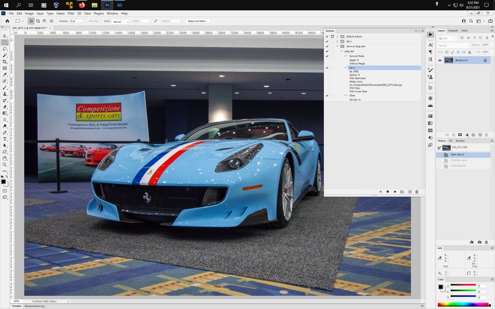

Aug 21, 2021 Aug 21, 2021
So far, i can only get the action recording issue as the op describes it, when opening a camera raw file from Lightroom Classic 10.4 into photoshop 22.5. Tiff and jpeg files opened from lightroom into photoshop do not exhibit the same action recording issue.

Original file used to make action was new document in Photoshop original name of Untitled-1 was retained and it was a jpg file.
Result
Path only recorded on action save location.
