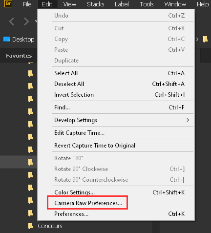

In the ACR Preferences, you can get there through Bridge (Edit menu, Camera RAW Preferences), On the File Handling tab set the JPG and TIFF Handling to "Disable TIFF Support".
