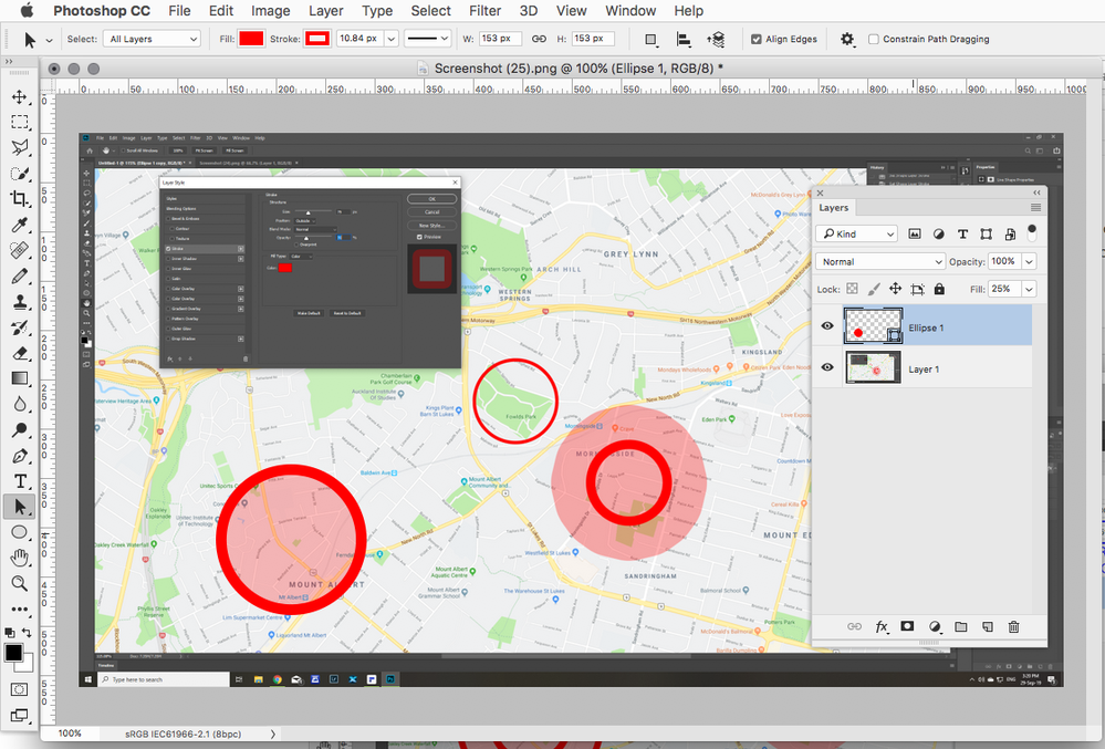

Hi all,
Why is it that I cant find anywhere how to create a filled circle with the same color border but with a different opacity?
Now to explain so I dont get unwanted answers.
I can easily create a ring with a solid color and make the thickness of the ring whatever I like. And I can change the opcacity no problem. I can also create a fill circle and change the color and make the opacity whatever I like, easy!
But when I try to make a red filled circle with faded opacity and then have a solid border the same color I cant find any videos on youtube explaining how to do this. Surely it cant be that difficult.

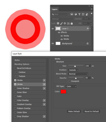

Create the filled circle, as a shape layer, and not as a layer style. Then use layer style to create the stroke. Then use fill opacity to control the opacity of the fill.
Sep 28, 2019 Sep 28, 2019
Have you thought of using Layer Styles?
Double click the layer to open Layer Styles, and use Strokes.
Stacked Layer Styles work a bit like normal layers, in that the upper one overwrites those beneath it.
So I start with a filled circle and set its _fill_ opacity to 50% this affects the filled circle, but NOT any layer styles you apply.
I have added a 50 pixel stroke with opacity set to 100%
Then add another Stroke beneath it (by clicking the + sign) and making its size larger, and opacity lower.  This gives us the overlap
If you need to go a different way then give us some more information, and we'll explain how to achieve it.
Good luck. 😊

Screenshot (27).pngThank you for helping out. But these haven't worked. I got it to work in reverse now though. See picture.
I know I can do it with two circles but you kind of have to guess where the other circle fits inside. Surely there is a way to do it using one circle. See my picture here this is what I want but the solid line on the outside, with the faded opacity on the inside.
