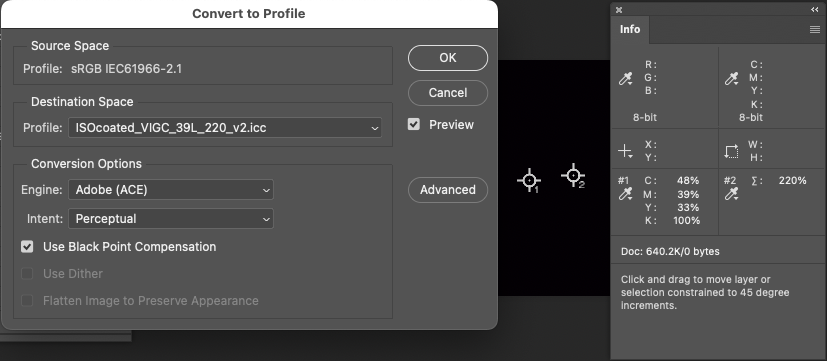

It is very common for print service providers to ask for very large areas of rich black (often artificial panels) to be limited in total ink at a much lower value than the four colour black found in photographic images which don't usually have large solid areas (yes, there are photographic exceptions).
Anyway, they have quoted 220% total ink. This should be more critical than hitting 40cmy100k.
100k is important though as it will add more density than the other colours.
All that being said, you do need to know the press condition to convert to, regardless of any post separation editing to hit specific CMYK values.
For example, the following RGB black conversion to CMYK is for the Fogra39/ISO Coated v2 condition, using a profile created with a 220% ink limit:
