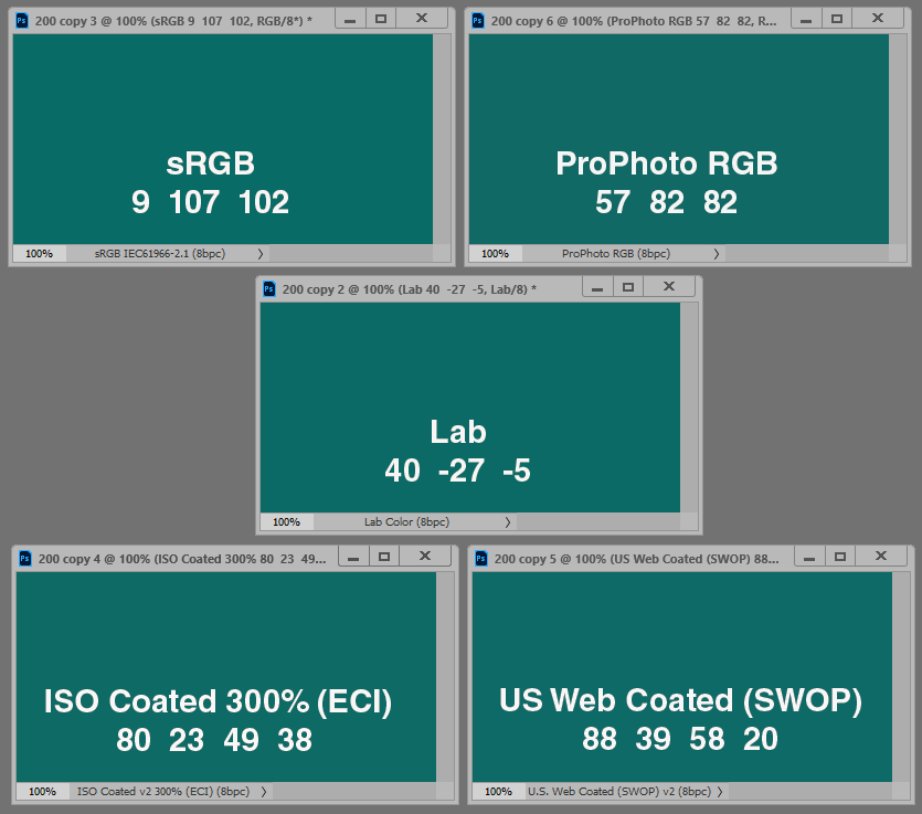

Nov 11, 2025 Nov 11, 2025
quote
But what about the actual tonal value %?
Look at the values using the info panel. The value is compensated for.
By @Stephen Marsh
To illustrate my previous comment:
When evaluated with their respective profiles - the sRGB, 20% gray dot gain and 25% gray dot gain all have the same Lab value... However you can see that the gray value for the 25% conversion is 5% lighter than the 20% conversion.

I don't want to interrupt this prepress discussion (my expertise is as a working photographer) - but what you still have trouble with is the basic principle of color management, whether applied to RGB or grayscale, or document, display or print.
Yes, numbers will change with different profiles, even when they look the same. RGB or K%, same principle.
The key is that there is a reference to it all, the profile connection space, PCS. All conversions go through there, whether it's from document to document, or from document to your display, or from document to print. The PCS is either Lab or CIE XYZ, but people will usually be more familiar with Lab.
Since I'm a visual guy, here's how it works:

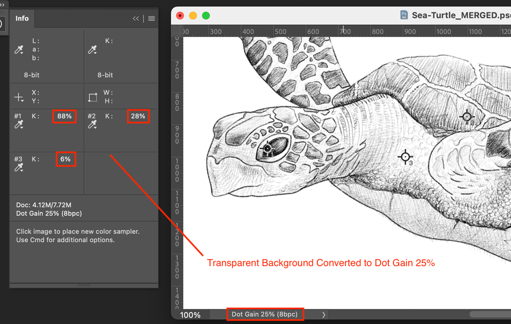

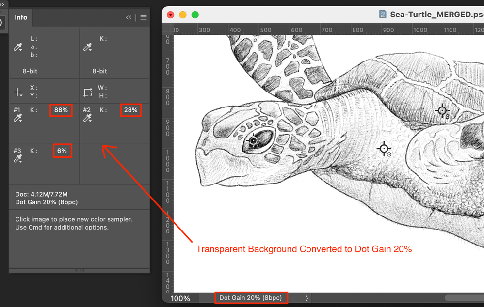

New Here ,
I want to thank you all for taking the time to help me understand color management better. I really appreciate all the info provided! I think this is where I am getting hung up:
When I merge transparent layers and convert to Grayscale there seems to be a glitch. I do not get the same results when the background is transparent vs having a white background.

Unpredictable Results = Converting to grayscale with transparent background
  • Image appearance lightens in photoshop and K% values are lower than if converted with white background
  • Dot Gain 25% K values are higher than Dot Gain 20% K values (unexpected)
  • (Note: a White background was added after merging and converting, otherwise all K% values show as 100%…)

Am I doing something wrong or is this a glitch? I don't want a white background, but I'm not sure which method is more accurate so that the illustrations do not print out too dark for web offset on uncoated natural stock.

Argh, sorry, uploaded the wrong images for the second set…
  • Dot Gain 20 and 25% K values  are the same (unexpected)
