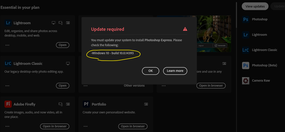

Another thing worth noting is that, from Creative Cloud Desktop, when hovering to Photoshop Express, it says "You must update your system to install Photoshop EXPRESS. Please check the following: Windows 10 build 10.0.14393", but I'm using Windows 11 with RTX 3050 4GB.

The other issue concerning Photoshop Express saying i must update my system to install Photoshop Express.
Adobe Creative Cloud still sees my laptop as Windows 10 instead of Windows 11.

The update OS notice in the CC app is something we've seen with the Opera web browser, which reported MacOS to the CC app instead of Windows. Try a different browser (even if you're not using Opera).
