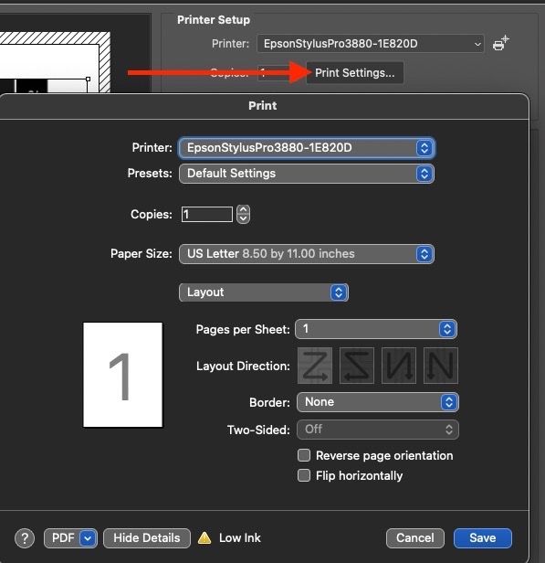

Can you post screen grabs of both in terms of setup?
Epson Print Layout uses a different CMM (it's not ACE) so this could be a Black Point Compensation issue; what Rendering Intent is selected?

First, I just used the last release of Photoshop 2021 and Epson Print Layout (1.5.2) using a color reference image and the two prints match exactly. Perceptual with BPC. So there is no issue on this end under Big Sur (latest version).
The test image was:
http://www.digitaldog.net/files/2014PrinterTestFileFlat.tif.zip
Next, in your screen capture, I have n o idea how you setup Photoshop's print driver but the bottom line is, with an Epson 3880, Big Sur, Photoshop and Epson Print Layout (and my own custom ICC printer profile for Luster paper), the two match. There's no 'issue' per se with Photoshop.
Author “Color Management for Photographers" & "Photoshop CC Color Management/pluralsight"

@rick3403 wrote:
My setting are the same as they were two weeks ago.  The only difference was that I was using OSX 10 with Photoshop 2020.
Can't replicate your issue with either Photoshop 2021, Epson Print Utility or an Epson Pro printer.
To setup Photoshop's print driver setting, you click on this of course and then screen grab all the pertinent settings that affect output:
ALL my settings are correct, in both locations, both prints match and both prints match older prints of the same document.
Again, I can't find anything wrong with Photoshop printing with color profiles. Nor EPL.

LEGEND ,
Jun 13, 2021 Jun 13, 2021
Copy link to clipboard
Copied
2nd screen capture, turn off 16-bit check box, any difference?

Community Beginner ,
Jun 14, 2021 Jun 14, 2021
Copied
Well, that corrected it.  I must ask, why did you suggest turning 16-bit off?  I have had that checked for years now and no problems.  The reason it was checked is that I have noticed a slight difference in the highlights and shadows of 16-bit images.  Why would this suddenly have caused the color to be off?

LEGEND ,
Copied
You turn it off because it doesn't do a darn thing for the output for one. And I've output 16-bit targets and then the same as 8-bits per color, measured them with a Spectrophotometer and the colorimetric differences are invisible. The option, which is now gone from more modern Epson printers, and was never an option outside the Mac drivers doesn't do anything.
The 2nd reason to turn it off is it fixes a BUG in the driver that made your prints look wrong.
