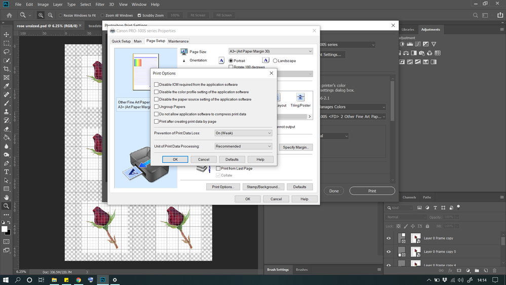

Hi
Can you show two more screenshots please.
1. The Photoshop print dialogue "Colour management" settings
2. The Canon printer driver dialogue "Print Options"
Thanks
Dave
Jan 15, 2020 Jan 15, 2020
You sent me the two screenshots and they showed nothing untoward.
There is one more possibility that I can't test here as I use an Epson P5000 printer , not a Canon.
The Canon print driver could be scaling internally and, in doing so, softening the image.
So as a final step, try this:
a. Use Photoshop Image >Image Size with resample checked and resample set to Automatic to change the resolution to 300ppi which IIRC was the "native " driver resolution for Canon. Try a test print.
If that is still soft try a small amount of print sharpening.
So after step a. (resampling to 300ppi) put all the layers in a single smart object and go to Filter > Sharpen >Unsharp mask. Try Amount 90% Radius 1.0 and Threshold 0%
Try a second test print and compare the output to the unsharpened Photoshop version (step back in history)
Dave
Using auto size, and some sharpening seems to be doing the trick, i've tried it on 2 prints. thanks again for the advice, i can finally do my prints properly!
Thanks for confirming. It sounds like the print driver was indeed doing some scaling. At least doing it in Photoshop you get to control it. A little extra sharpening before printing is not unusual. The trick is not to overdo it.
