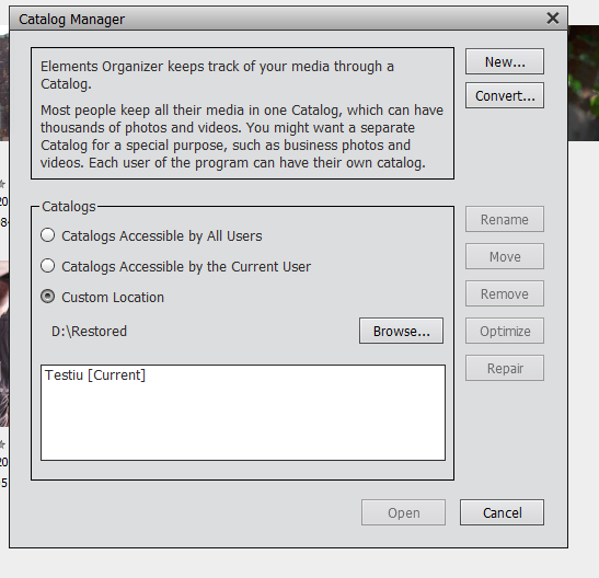

Adobe Employee ,
Sep 24, 2017 Sep 24, 2017
Hi mp,
As the Catalog is restored on an external drive and the files are present in the catalog only. You have to select the catalog restored. So to get your catalog and data back just go to "Manage Calaog-> Custom Location" option and select the parent folder of your restored catalog.
So to do this go to "Manage Calaog-> Custom Location" option and select the parent folder of your restored catalog.
Once you select the parent folder of your restored catalog, you will be able to see the catalog you restored, select the catalog. Please refer the screenshot attached.
Kindly revert if still there is any doubt. Your feedback is really appreciated.
Rahul
New Here ,
Sep 25, 2017 Sep 25, 2017
Rahul:
Thank you for the reply.
I followed the directions, selecting the primary catalog on the (H): drive - (H:)\All My Photos\NikonPhotos - that Elements has defaulted to since setup, but nothing else happened.  After designating (H:)\All My Photos\NikonPhotos, should I then click "New" or "Convert" in the upper right hand corner?  This also occurred to me, the primary catalog on the (H:) drive and the backup catalog on the (I:) drive are both called NikonPhotos; should I rename the backup catalog to, for example, Backup NikonPhotos?
