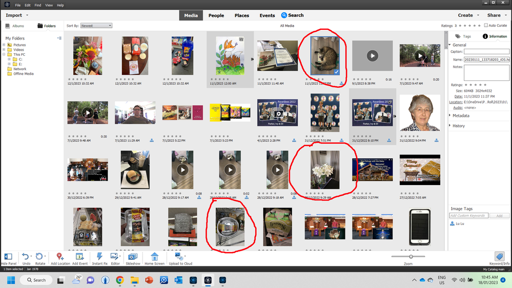

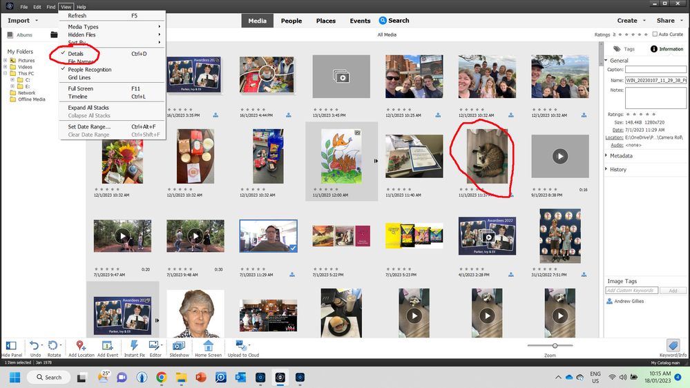

Hi again everybody. I may have a very easy partial solution. I have found that the weird behaviour of thumbnails only happens when datails is not ticked in the view menu. The thumbnails appear to be correct in the details view and stable. this makes the program workable. The weird behaviour still should not happen when not in details view and it is VERY annoying but if I am right "Hallelujah!!!" Photos in this post details view not selected and selected. In "not selected" three completely different photos that have the same thumnail due to the glitch. In "selected" the original photo circled with the correct thumbnail. 2023-01-18 (6).jpg2023-01-18 (7).jpg

Here is the details view with all three correct thumbnails selected.2023-01-18 (9) copy.png

@Gilsworth thanks for your investigation, but I hate to burst your bubble.   I always work in Details View and have easily reproduced the problem in that view.

It seems more stable in details view. In the other view it's like watching twinkling stars or something. Some thumbnals are steady others change from one thumbnail to another and others cycle through one thumbnail andother and black. At the moment (everything crossed) detail view seems stable and the thumbnails seem to correspond to the heic files. I hope you're wrong but you have much more experience than me so I will just shed a few silent tears of diappointment.
