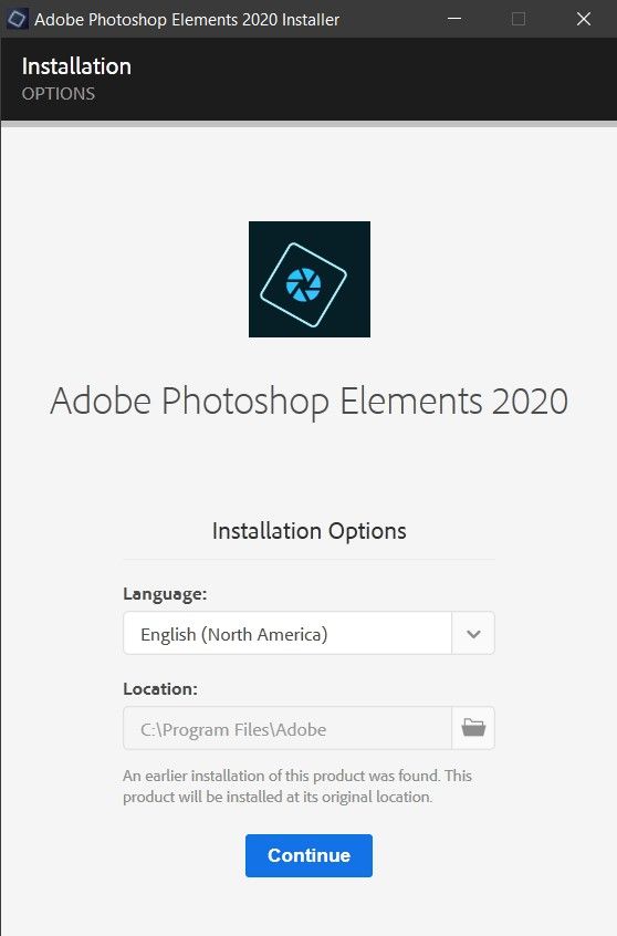

PSE 2020 was installed and running fine on my Windows 10 laptop PC. I think it had even gotten updated to version 2020.1 My laptop has an Intel i7-7700 CPU with an onboard Intel graphics GPU. It also has a discrete Nvidia GeForce GTX 1050 Ti GPU. I prefer to use the Nvidia GPU, so I had the onboard Intel GPU disabled in Device Manager and everything ran fine ... until a problem updating my Nvidia graphics driver caused a problem that re-enabled the Intel GPU. Even after I disabled the Intel GPU again PSE 2020 would only use the Intel GPU - it would NOT use the Nvidia GPU!
So, I uninstalled PSE 2020 thinking that when I reinstalled, it would correctly use the Nvidia GPU. Now, it will NOT reinstall. The install starts up fine and begins, then when it gets to 6% it stops with Error Code: 199. The "Get Help" link does not list Error Code 199. I've tried reinstalling numerous times and always get the same error.
What do I need to do to reinstall PSE 2020 onto my laptop??
Here are a few screenshots of my reinstall attempts.
The Install BeginsThe Install BeginsIt Gets To 6%It Gets To 6%Then It Stops With This Error!Then It Stops With This Error!
