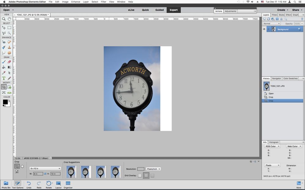

Something like this might work:
Example image used is from:
https://www.imaging-resource.com/PRODS/D90/D90GALLERY.HTM
1. Set the Crop Tool to No Restriction and draw out the crop to the full image
2. Grab the lower right handle and pull out a substantial amount past the image area
    and click the Green check mark.
3. Set the Crop Tool to 8 x 10 and pull out the crop to put a white border on right side of the
    image and click the green check mark.
The screenshots above are attached below if you want larger views than the forum offers
