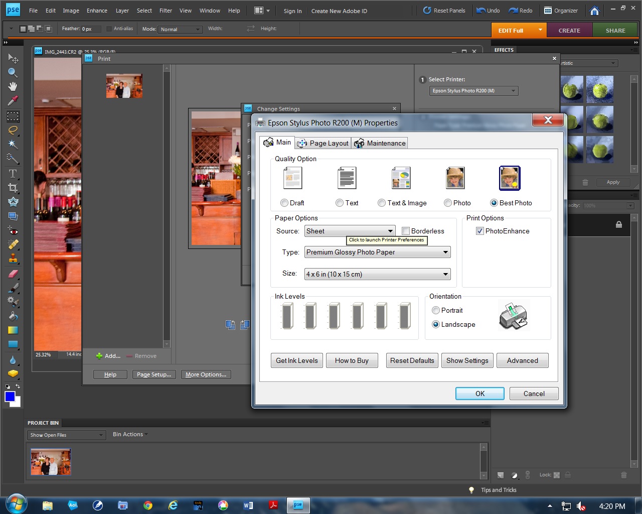

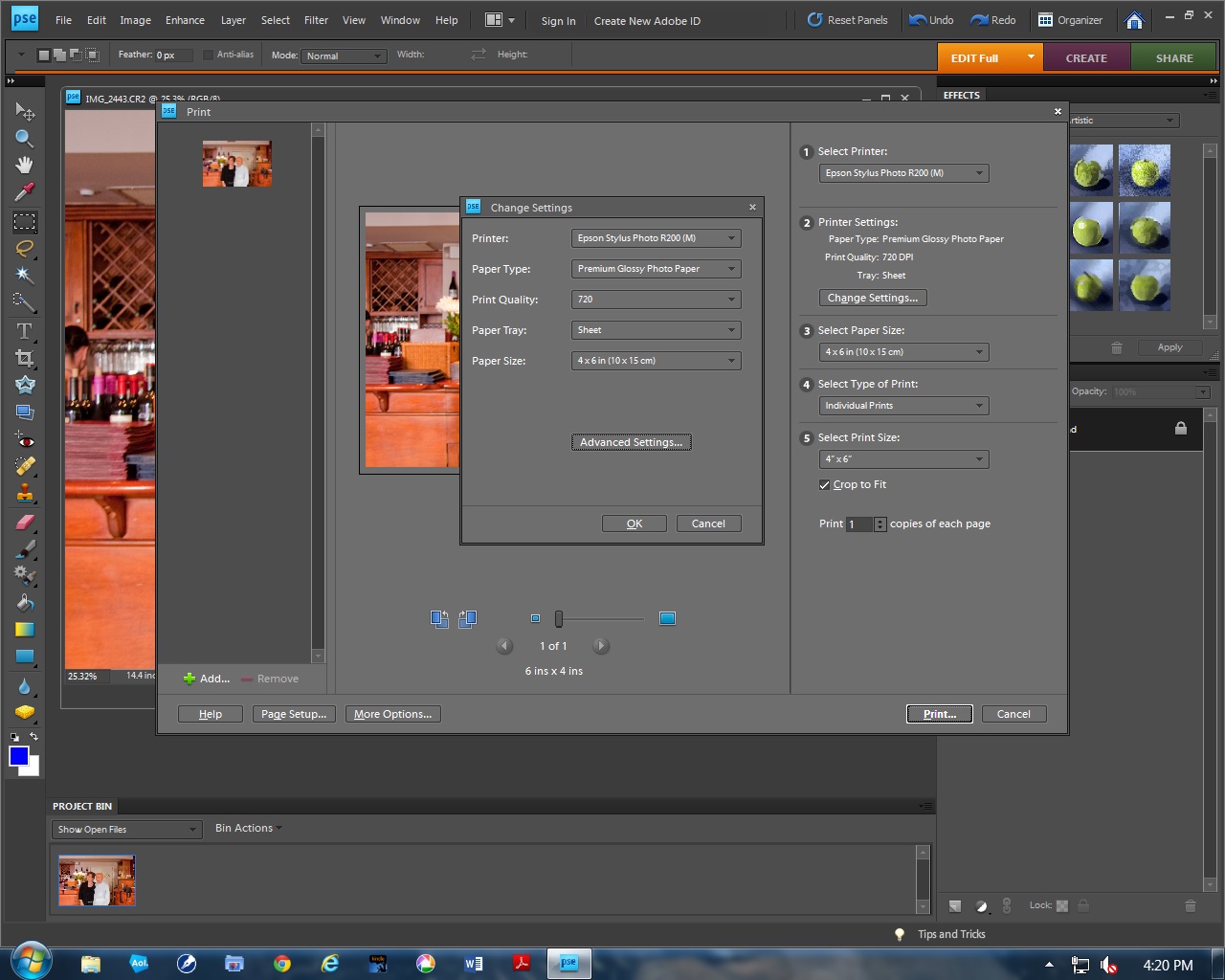

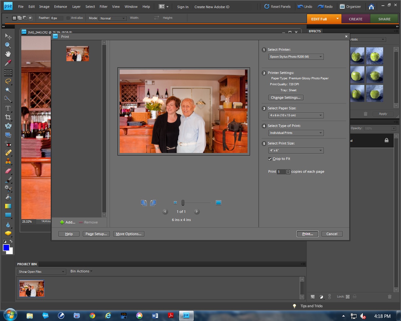

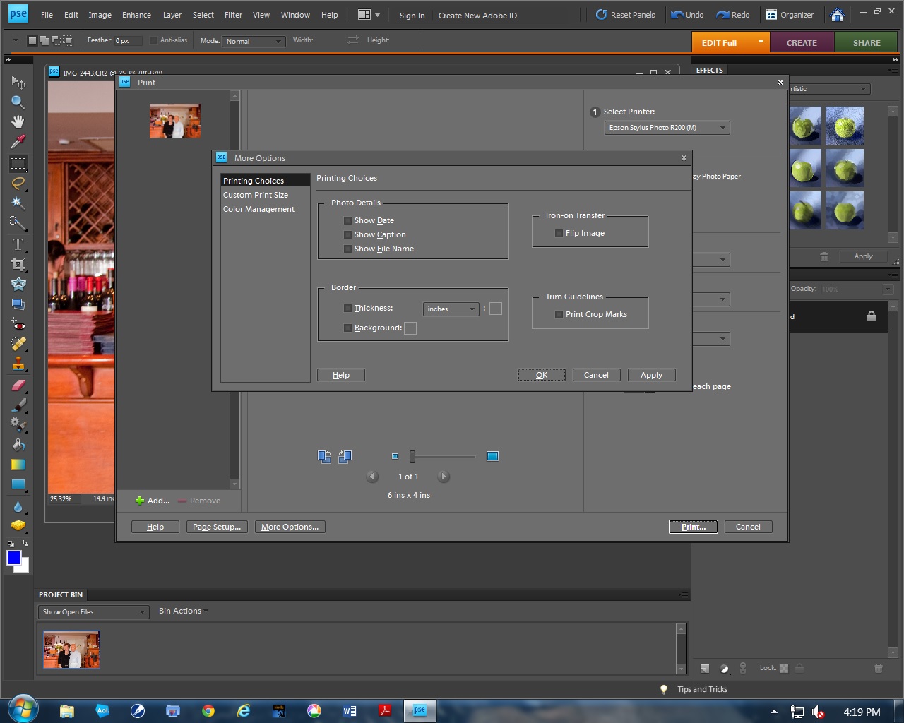

When you reply to an email to post to the forum, attached images will not be posted. You have to visit the forum website and then use the Insert Image button.
New Here ,
Jul 17, 2013 Jul 17, 2013
New Here ,

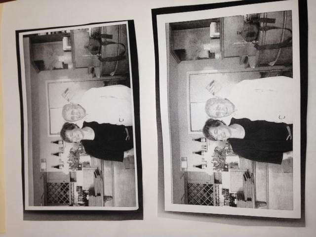

Screen shots have been set.  also,I  am trying to send you jpegs of the picutres - one as printed in 11 and one as printed in 8, but I get a message saying the content is not allowed.  I will try again to figure out how to do that sinceIi think when you see the difference, it will make very clear what I am  talking about.  thanks.
New Here ,
Jul 18, 2013 Jul 18, 2013
these are the same picture, same size, printed on the same computer, with no changes to the print setting.  One is Photo 11 (wide margin) the other is Photo 8 (narrow margin)  I think this explains the problem. And you now have screen shots of all the settings.   What I want is the narrow margin.  I hope that you can now tell me what do to to make the change.  thanks for your efforts.

Thanks for the images of the prints. I do notice that the image is being cropped on all sides. This is odd as cropping should only occur on two edges when Crop to Fit is enabled. This setting will make an image fit the printed aspect ratio (4x6 in this particular case). It appears that this latest image that you are printing isn't natively 4x6, as even in PSE8 cropping is occuring. This can be clearly seen in the first three screen shots of the latest set you've provided. You can see both the original image and the print preview at the same time. On the far left of each there is the back of a woman's head. In the print preview, you can see less of her head due to the cropping. It's hard to say for sure, but it also appears that cropping is happening along the top as well. This suggests that cropping is happening on all sides.
Try unchecking the Crop to Fit option at the bottom of the right column of print options to see how this effects the preview of the image in the Print dialog.

Changing the Crop to Fit option should alternate between the image fully fitting the frame (no blank areas) and being reduced in size to fit the frame on the long border (creating blank areas on the short border), unless the image exactly fits the print size (same aspect ratio).
As I continue to analyze your screen shots on notice other differences to what I see on my side. In the preview area of the Print dialog, The heavy black line around the print is the document boundaries, the actual size of the paper. Then there is a dark grey border region, which is the margin, then there is the picture itself. If you are using a Print Size smaller than the Paper Size, you will get a blue border around your print, and white for anywhere you'd have blank paper (when you disable Crop to Fit, the extra blank area will be within this blue boundary). When I look at things on my side, the margin area is not the same dark grey that you have, but the same light grey as the rest of the dialog window background. This difference comes from the instructions supplied by your printer's drivers.
I did a little check and found that your printer was discontinued a few years back, it's printer driver was last updated in 2009. This could be the source of the conflict between the newer version of Elements and why the older version is working differently (since it was released around the same time).
Adobe Employee ,
Jul 29, 2013 Jul 29, 2013

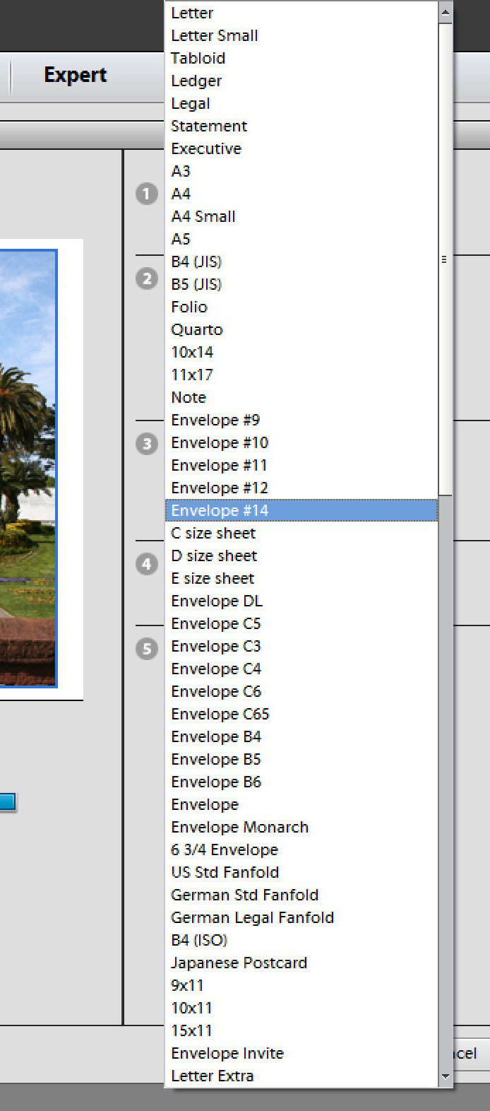

Let me show you a little of what I see on my side to show you how much of what you see in the print dialog is actually controlled by your printer:
Here is my print dialog, not the area around the Print Size (outside the blue line) is not the dark grey it is on your side:
Here is the list of available paper types for this the Microsoft XPS Document Printer (a vitual printer, it creates documents similiar to a PDF and is installed by MS Office):
But the list is much smaller which I switch to a different printer, and also includes some borderless options:
