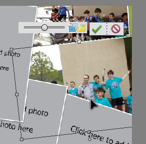

Double-clicking an image in the collage also brings up a control for replacement of the image and also a zoom slider.

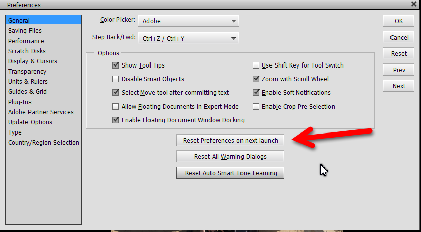

If this does not populate the photo collage automatically for you, I would suggest resetting the preferences file.  (I'm assuming that Macs have a similar Preferences dialog as Windows):

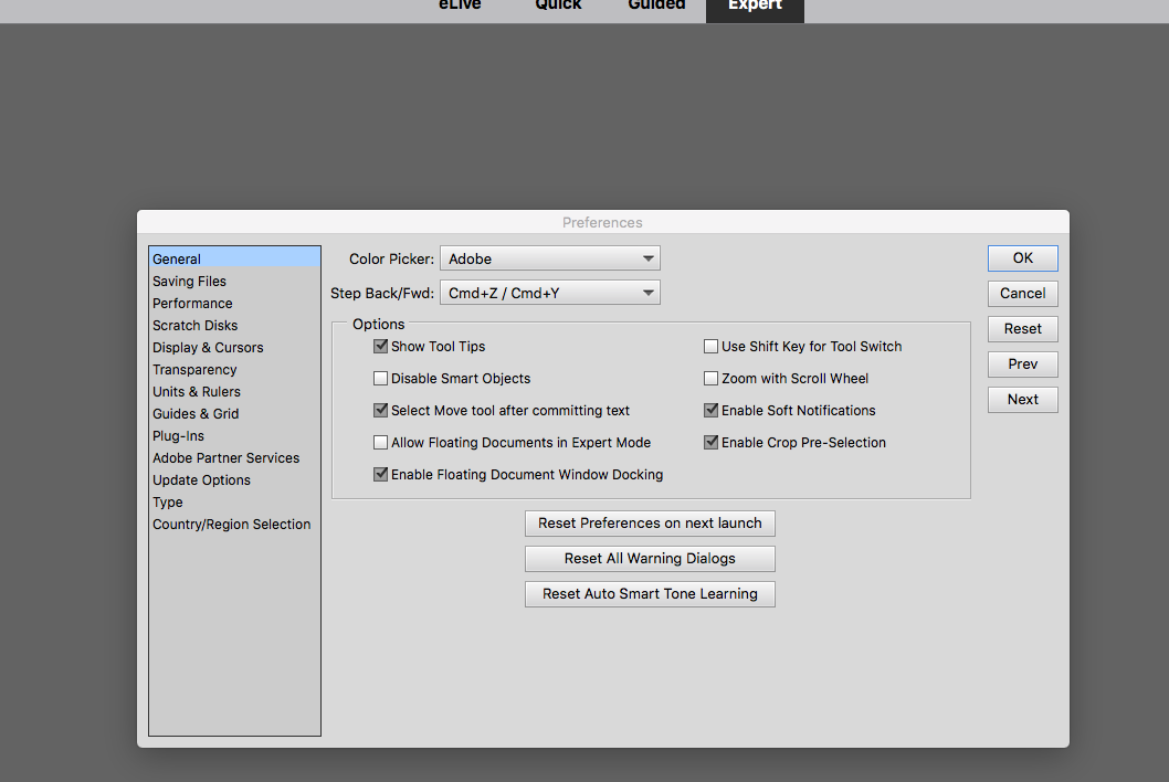

I am at the machine, So I tried again and this time it worked. And with two different sets of photos. I have no idea why !! I thought it might be the the blue hightlighted was that last photo in the bin, However, it did not seem to make a difference. I did not reset my preference from where they were pior to the retry. I will attach an image of the general page. These have not changed since install that I know of. They are different then the image you put up. Is one prferable to another ?
Thanks
Mar 22, 2019 Mar 22, 2019
As the name implies, preferences are a matter of personal preference.  Whenever I install a new version of Elements, I always enable Zoom with Scroll Wheel.  For me, that is the easiest way to zoom in and out of an image.  I also disable the default Enable Crop Pre-selection as I find it annoying.  But that's me!
