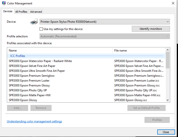

Hi again Halstead,
I just want to confirm that what I have done is correct.
I am able to do everything you proposed except the instructions below "That should do it"
I opened the R3000 through the shot cut I have on the desktop ( there is no icon in the Task bar )
Not through the Elements Editor create option.
It opens on the "Settings" menu.
From the settings menu  >Properties   I can find no check box or option to check color.
There is however a " Colour Management" Tab, this opens the "Colour Management" menu
in the "Devices" Tab.
There is a Profile Selection field which is grayed out but has the message "Automatic ( Recommended )
I am sure if this were not greyed out there would be a drop down menu with more options.
There is however no "More Options"  option.
I will try and attach the relevant screen shots.
Have I done all that I require to do?
