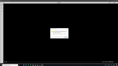

When I create a slideshow from the organizer part of the screen ( upper and to the right ) is not visible.
Please see attached screenshot.
The slideshow plays then ends like this.
There is no way to navigate out apart from "Esc" then abort the file save.
The only troubleshooting I can find is about updating the graphics drivers which I've checked and both are ok.
The application is running on a modern Dell XPS15 on Windows 10 and is fully up to date.
I have never come across any other screen issue on any of the other applications I run on this machine.
Any help would be very much appreciated.

Further point :
I also forgot to say when I tested it with just the NVIDIA driver enabled PSE came up with an error message about the driver which did seem strange becasue it actally has an NVIDIA driver intalled - please see attached
May 05, 2020 May 05, 2020
I don't claim to be an expert on this.  My understanding is that Intel marketed the integrated graphics card as a way to reduce the cost of a computer - no separate card needed.  But gamers would not be satisfied with the onboard graphics and would require additional cards.  Presumably, both GPUs can be optimized to run together for certain software and overall performance can be increased.
I have no idea why disabling the Intel graphics would slow down the machine as a whole. Did you reboot after disabling?  There may be some other settings that need to be adjusted in the BIOS or elsewhere.  (That's above my pay grade.  😁)
AFAIK, it is only the slideshow module (which requires video playback capability) that has any problem with dual GPUs.
As for the error message you have posted, it is too small for me to read.  Perhaps you can post exactly what it says.
