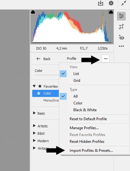

I'd like to get some info from Adobe, but I have seen that there is somewhere an option in the ACR version of PSE2021 to use presets created for Photoshop. In the 'profiles' menu (the 3 dots icon for more presets options), there is an option: "Import profiles and presets". I have not found how to use it.

Re. Q2: My PSE 2021/ACR looks different (when I click on the 3 dots)... I don't get the same dropdown choices as you do:

Jim, the three dots are on the 'profile' line, a bit under and left of the other three dots icon.
You have to select the icon to 'browse' profiles first.

I just figured that (need to browse first) out so now I see the same menu as you.
