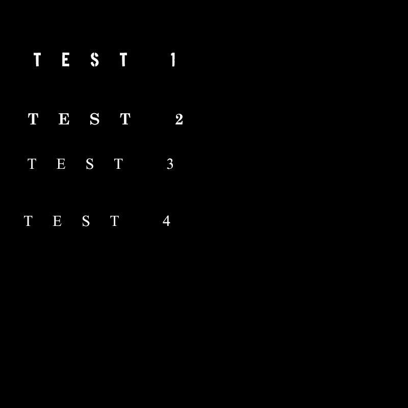

I have an issue that is frustrating me to no end because I can't figure out how to fix it.
Basically, I use the text tool a lot and have NEVER experienced any issues.
I made 4 photos back to back, each containing tons of text - no issue.
Then I start work on the 5th, and out of nowhere, the text is all messed up. It's all awkwardly spaced out now.
I've been searching online for a solution, and I've seen a lot of people talk about tracking and kerning and asian text.......but following all of the procedures people have mentioned in other forums - nothing works at all.
And again, the font use to never look like this. I have no idea what i did, or what may have happened - but it sure would be awesome to get it fixed.
Anyone have any ideas?
The picture below is just 4 random fonts that I have used on past projects - which never use to be so spaced out. ALL of my fonts are super spaced out now
Thanks for any replies that might hint towards a solution.
730
Community Expert , Jun 30, 2019 Jun 30, 2019
Suggest that you reset the  type tool to default. In older versions of the software, on the type tool's option bar, look for a little triangle, top left. Click on this to reset. In newer versions, on the option bar, look for a box with lines in it, bottom right, then click on this.
If that does not fix it, reset preferences. To do that, go to Edit>Preferences>General and look for this:
New Here ,
Resetting the preferences as you mentioned seemed to do the trick..... Do you have any idea what I may have done to make the fonts go crazy? I have no idea because when I select the Text tool, the options that appear at the bottom of my screen - nothing out of the ordinary...for what I can see - everything is the same - but obviously there is a setting somewhere, or I accidentally hit a shortcut key to do something, i just dont know what
