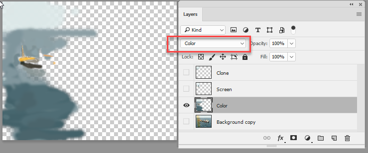

If you take this in steps.
We started here:
The first step is to address that yellow color. I add a new layer and in the layers panel set blending mode to color. This means that the color will be used but the luminosity (i.e. the "brightness") will use the layer below so will not be changed.
I then use a soft brush and use Alt-click to pick up color from other parts of the image which I then brush on.
You don't even have to be exact as the detail is taken from the unchanged original layer.
On it's own my color layer looks like this:
But when combined with the layer below it looks like this:

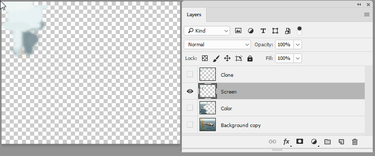

The next step is to address the brightness. So I add another layer this time with blending mode set to screen. This will lighten any areas I brush with a lighter color. I have set the opacity very low and brushed very lightly onto the grey stain, using a brush again Alt clicking on nearby areas. The idea is to lighten just enough to blend the stain.
I have shown the brushing at 100% opacity and normal blend below:
But when set to screen - opacity down 10 11% and blended with the layers below it looks like this:
