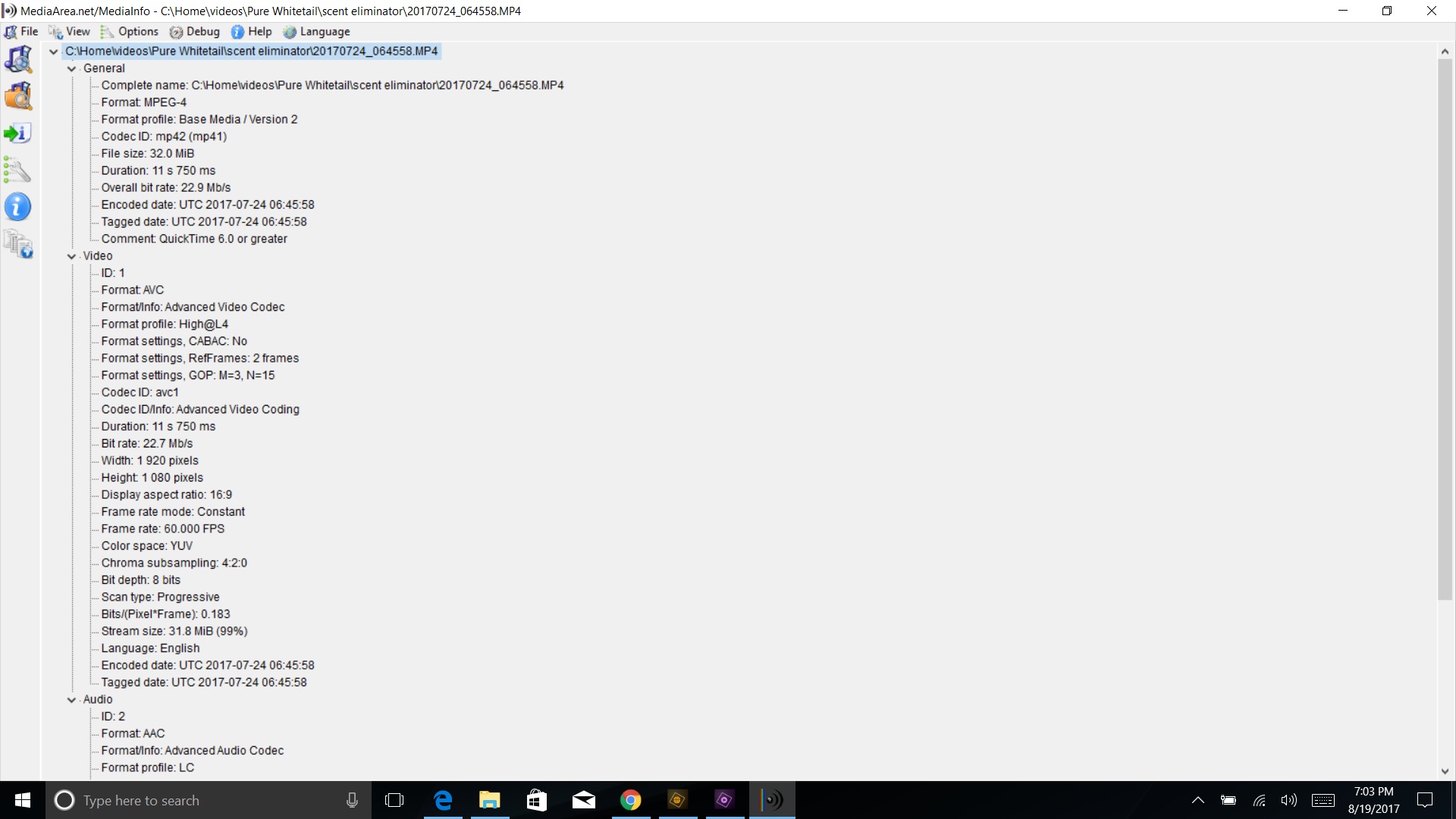

Please open one of those videos in the free download MediaInfo. Set MediaInfo's View to Tree and then cut and paste the data it reports to this forum.

New Here ,
Aug 19, 2017 Aug 19, 2017
LEGEND ,
There is nothing in this report that would indicate why you're having trouble editing this video. It seems like a pretty standard MP4.

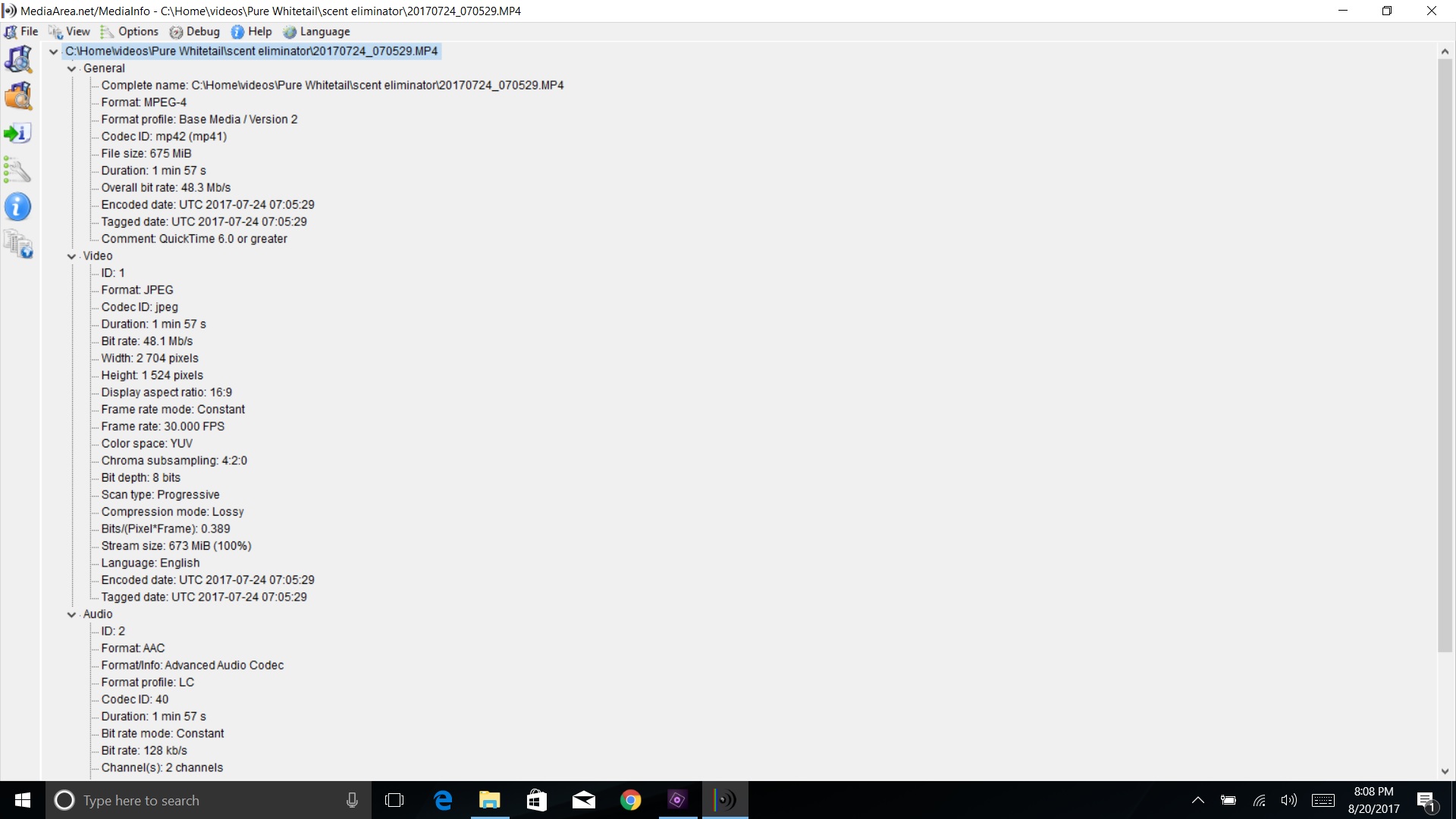

Hi Steve, I installed Quicktime as suggested and seem to have the same problem.  However, I did notice something.  I recorded about 9 segments at the same time, all at the same settings on the camera.  However, I was only trying to work with some of the later files.  The details above were from one of the first 4, which I had not been working with, but I appear to be able to pull in as videos.  The last 5 segments, however will not.  There appear to be some differences in the details of the first 4 and the last 5.  I'm not sure what would have caused the differences.  The Tactacam is fairly simple, you either pic normal speed @ 1x magnification, normal speed @5x magnification, or recording at Slo Mo for more fps.  Again, I recorded them all at 1x@normal speed.  Not sure if the card being used or anything else could have caused a difference in the later files.  Regardless, here are the details of one of the files I need to use.  Any feedback is greatly appreciated.tactacam4VideoFileDetails2.jpg
LEGEND ,
Aug 20, 2017 Aug 20, 2017
The biggest issue here is your video's dimensions -- 2704x1524. Though your video is also using something called an MP24 video codec. That's some pretty non-standard video.
You're not going to be able to work with a video with those specs in Premiere Elements.
You can try using Handbrake to convert the video to a 1920x1080 MP4. It's going to lose a lot of resolution, but at least you'll be able to edit it.
