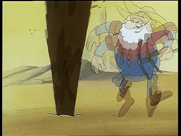

I stumbled across a weird problem while working on a problem with a lot of SD footage from DVD.
A quick primer to set the stage:
The material in question was originally shot on film and comes from PAL DVDs. Europe deals with film on TV in a straight forward way. It is played back at 25fps and every frame is shown as two frames of video - so there is no real difference between progressive and interlaced DVDs like in the US. All DVDs are 25fps and you either treat it as progressive or 50Hz interlaced.
My problem:
Most of the material is fine. Every frame of film was scanned as two frames of video (top field- bottom field) when it was telecined back in the 80s and when it was digitzed those two fields became one frame again.
But for a little over 30% the cadence is wrong. and it was telecined as bottom field - top field. Back in the days of CRTs this was no issue but now every digital frame consists of to fields that don't belong together.
On a base level I would need to split a frame (F1) into to fields (F1a and F1b) and then match F1b with F2a, F2b with F3a and so on. I could treat the footage as interlaced but that leads to a loss in resolution. Is there a way to correct what someone messed up in 1983? 😄
