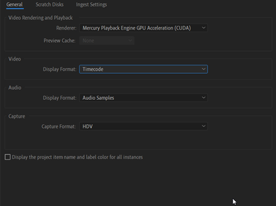

To clarify: These are the properties of the clip, that loses all quality when downscaling (its made with Camtasia):

Program monitor, do you mean the preview in PP? I always export to see the result. Will chosing "full quality on playback and paused resolution and "high quality playback" improve the result? This is what I do:
