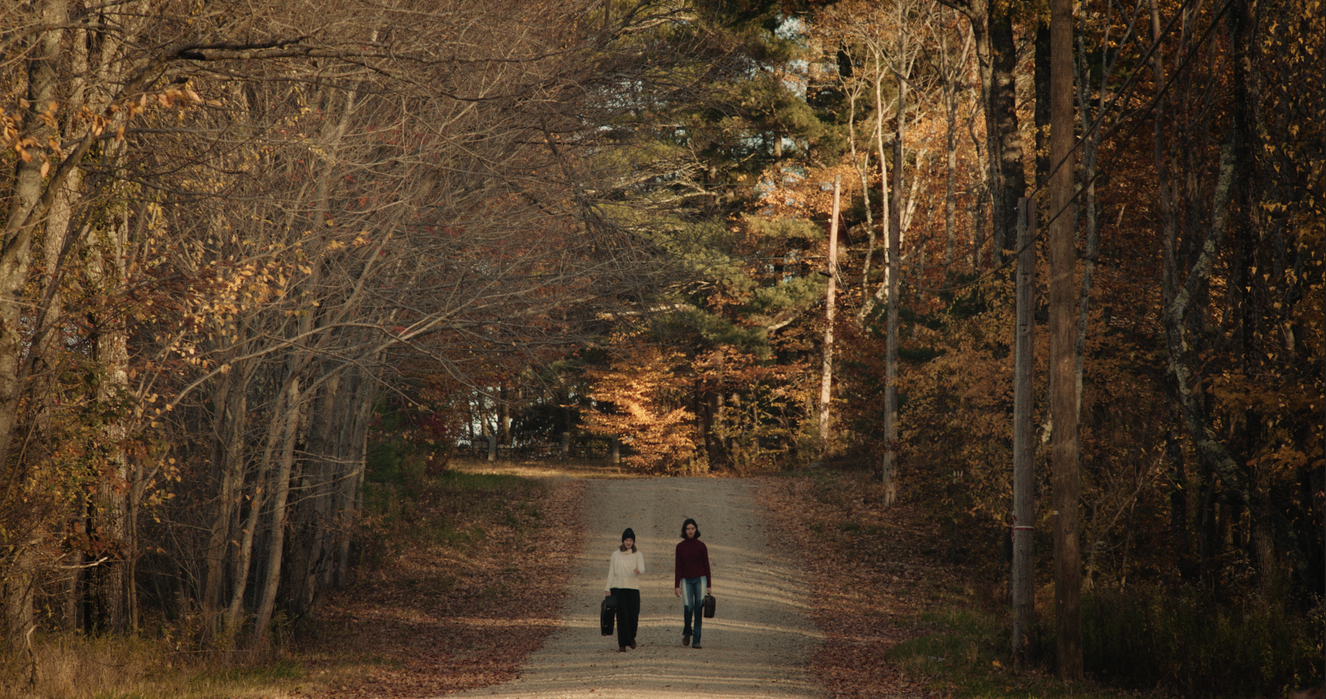

I recently have been diving into the color managment settings to correctly display color/luminence on my OSX /studio display for web uploads, and while setting my program display to 1.96(QT) and using a QT comp LUT on the exports seems to work for my exports, I just went to change my sequence frame size from 4096x2160 to 3840x2160 and in the process it once again made everything brighter in my program monitor.  Before/after and screenshot of my color managment settings. What gives?

Update: I find that even just opening and saving the sequence settings has the same effect.

Another update: After changing a setting within the lumetri panel in my first screenshot, it had the same effect as changing from the sequence panel, but this time it has "permamently" changed the gamma/contrast in my program monitor. I find that applying the QT comp lut produces the correct results in the export, but in the program monitor it now has "incorrect" gamma/contrast. Just confused a bit whats going on. Perhaps what I was viewing originally was simply my program monitor not correctly reading the settings, which is why when simply changing a different unrelated setting caused it everything to change as it was now actually reading the other color managment settings. So if we assume thats whats going on, does that mean my premier-pro specific settings are fubar causing the issue within the program monitor; so I should shift those; or are my color managment settings now correct and I have to re-grade all my footage? (keeping in mind the QT-comp LUT seems to fix the export result atleast)
