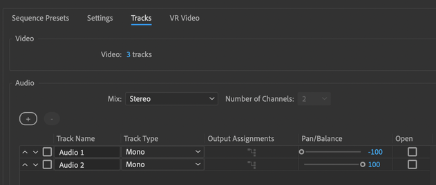

For Stereo Ch1=LT, Ch2=RT, I have created a sequence:
and then added audio:
If I choose to Export in Apple Prores 422 HQ, (what the company asked for),
  1. Do I set my output to 2 channel, or to stereo? (see image below)
  2.  Is there any way I can verify it has been exported correctly before I send it in and annoy their QC team with a file that isn't done right?
  3. Is this how you make a Ch1=LT Ch2=RT stereo file, or is there a better way?

If your video has been mixed for stereo, it sounds like the simplest solution is to provide a stereo export.
Add your stereo mix to a Standard track in a stereo sequence and export as stereo.
This will match the cinema's stereo requirement.
