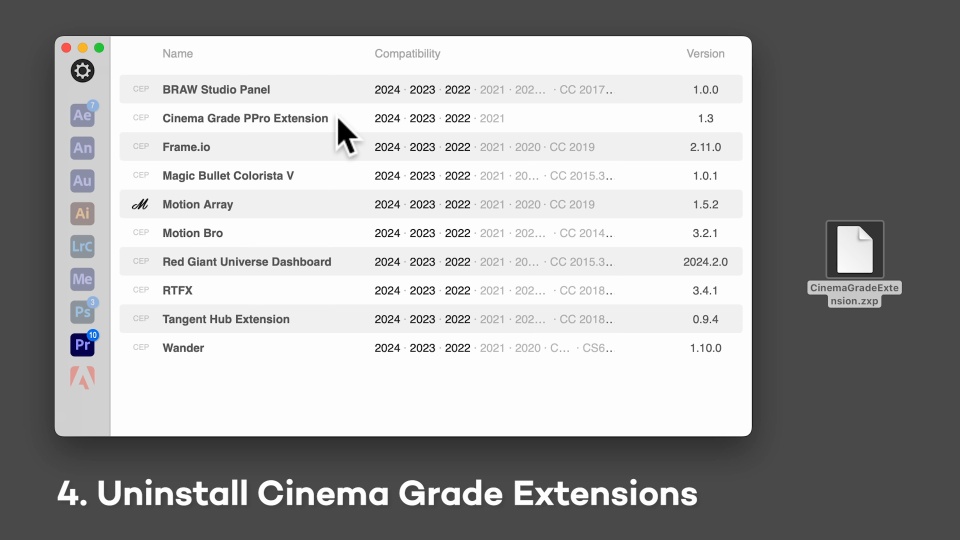

Happy to say I have a solution!!!
Ran into the same issue and stumbled on Cinema Grades YT channel and in the description they had a link going to a trouble shooting video for premiere. They make you download this extension thing and you just install it and everything starts to work like normal. (Note premiere for me didnt say there was an extension installed but it fixed it.)
Here is the link to the video https://colorgradingcentral.wistia.com/medias/y0vd7hdvm0 it will make you download 2 things.
HOPE THIS HELPS!!!!
Download AEScripts ZXP: https://aescripts.com/learn/zxp-installer/ Download Cinema Grade ZXP Extension: https://fd.cinemagrade.com/CinemaGrade/cdn/CinemaGradeExtension.zxp
