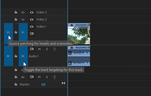

If you audio track is not source patched you wont get the audio.
Might want to read on Source patching and track targeting as they are important to editing.
Adobe Premiere Pro Help | Source patching and track targeting
You need to forget about CS2 as there has been a lot of changes over the years. You will only get more and more frustrated.

Advocate ,
Mar 27, 2019 Mar 27, 2019
I'm getting audio, problem that I've written in about is, the audio won't stay rendered.  Every time I open the program, I have to re render the timeline's audio tracks.   After I render it, I see the red line has changed to wave forms.  Looks and plays fine...  until I re start program again, then it's red line city.  BTW, the audio plays fine with the red line.
