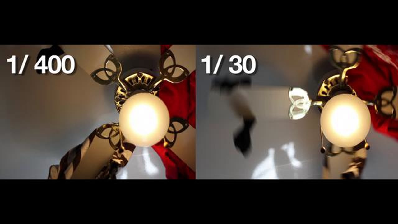

Also, here's a great video talking about the details: https://vimeo.com/19603537
It's like your setting of 1/100 is too fast and creating zero motion blur which is mistaken for choppiness.
Part 6 of my crash course on DSLR videography. While demonstrated on the Canon T2i, the technical principles are applicable to any camera and are crucial for any starting videographer who wants to improve their cinematic skillset (in relatively short order).
