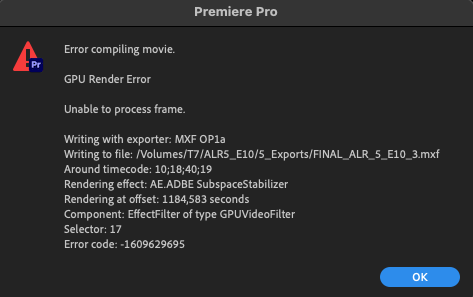

Exporting from Premiere to Media Encoder. It may be because of a FPS mess problem. Footage was shot in 23.976 and I have to deliver in 29.97 drop-frame. I put my 23.976 sequence in a 29.97 one and took off the extra frames to get to the right video lenght.
It is always crashing at the same spot. Tried exporting .mfx and mov, same thing always...
Can someone save me? 😭
Tried exporting right from Premiere, same probleme but further in the video (crashed at about 60% instead of 15% before)
