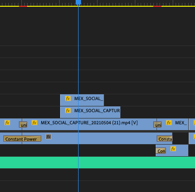

I have created a super simple timeline to demonstrate the issue. I've used a PiP moment to make it clear; in this screen grab you can see a BG clip, and two resized clips creating the PiP:
All three of the clips come from the same source media file, you can see the name on the clips on the timeline.
[img]https://i.postimg.cc/N0fb7z9h/Image3.png[/img]
I DO have Show Duplicate Frame Markers enabled, but as these clips are from different timecodes in the master source file, obviously the dup frame markers are not showing anything.
Now, I want to consolidate the media, so each clip on the timeline has a VERY specific number of handles and the clip is 100% independent; this is for addition post-production pipelines in VFX and grade.
However, when I go through the consolidation process, be it Project Manager or Render & Replace, if the clips on the timeline do share any frames, then the consolidated media files are merged into 1 file. This is bad. The transcoded media files should be absolutely unique and not shared with any other clips on the timeline, regardless of shared frames.

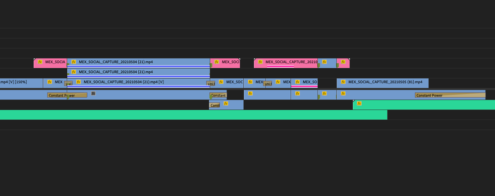

This is my new consolidated section of the timeline, as you can see, it all looks okay -
[img]https://i.postimg.cc/DzrJ0vyn/Image4.png[/img]
However, when I drag out the handles, you can see that the 25 frames handles are not there, and the Show Duplicate Frame Markers has kicked in, revealing that the 3 clips on the timeline do in fact share the same, newly transcoded, source media file-
[img]https://i.postimg.cc/7h2yP6wN/Image5.png[/img]
I need the consolidation to be absolute, like I said before, with each clip on the timeline having the same 25 frame handles. There can be no variations on this.
I did a quick work-around to demonstrate what the final result should be, but this involved doing each clip individually, which is obviously not practical in real world work environments, especially if your duplicated frames are hidden in handles. One can't be expected to drag out handles of every clip to see if there's any dupes. That would be insane. You can see in this image that I've dragged out the handles to their maximum, and each clip is exactly 25 frame handles, and you can also see that the name of each clip is different, with each clip having a unique source media file. This is what we need to have the option to create when using Project Manager and/or Render and Replace.

To make it simpler this time, I simply stacked the same clip for the PiP, which you can see from the Show Duplicate Frame Markers. I didn't bother with the handles thing because, well, let's cut to the point - if it can work with direct dupes it can work with handles.
Here's my PiP and my 'locked edit' pre-consolidated timeline, showing the dupe frame clips.
I got to the Project Manager, and set it up in the correct way -
Now, from this setting, I would expect the resulting Project that is created from this setting to make each clip on the timeline to have it's own, newly created, independent source media file, ie - the source media file is duplicated. Each clip on the timeline will also have 20 frame handles.
After the Consolidate and Transcode process I open the new project and the result is wrong, or maybe not 'wrong' but it certainly is not suitable for a sleak, efficient, VFX pipeline, or even for prepping for a Grade. This is not good.
This is the resulting timeline in my new project -
You can see that the 3 stacked clips are not independent, they share the same source media file, as revealed by the presence of the Show Duplicate Frame Markers.
I have dragged out a couple of the clips to the full extent of their handles, made an edit, and coloured the handles in Rose. So, basically, the Rose coloured bits are the handles of the clip.
You can see the 3 stacked clips do have the correct 20 frame handles, but that's only because each clip is a direct dupe so there's no variation. However, the other little clip to the right highlights the other problem - the left side handle of that clip is much longer because another clip on the timeline (in this case it's the clip immediately before, but it could be anywhere, same problem) shared some frames in their handles, so premiere decides to merge the resulting Consolidated/Transcoded clips together. You can see that the red Show Duplicated Frame Markers reveals that the 2 clips share the same source media file. This is not good.
It would be absolutely amazing, and SO EFFICIENT, if there was a simple check box that overrides this behaviour. Each clip on the timeline should be 100% absolutely independent, and not share the same source media file, regardless of dupes, etc.
Please discuss. If anyone has solved this in a practical way, I'd love to hear how...
