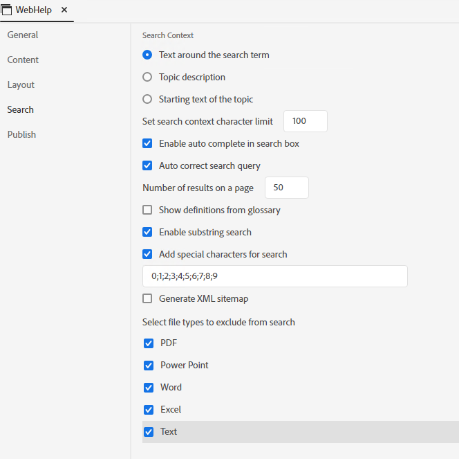

In robohelp output we have these settings for search
672

I have now tried to create a new output preset
And tried to expriment with a several different options in the searchtab but nothing get a reliable searchresult compared to the old build, the old one is the one thats give the correct answer.
What more could I expriment with?
I also found that in the example above when searching for "ordererkännade" that gives none result.
If I search for "ordererkänna" (which it not a correct term at all) I got in this specific case a correct answer
while the search for the correct term gives

I have made the experience that the setting "Auto correct search query" leads to quite strange search results in German language, so maybe this is also the case in Swedish. Maybe you could try if the results look more reliable with this setting turned off.
