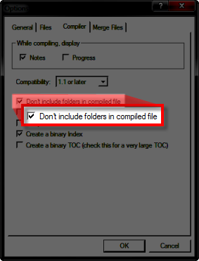

If you open HHW, you may do what you are seeking to do by clicking the Change Project Options button.
This should open the Options dialog.
From there, click the Compiler tab and enable the option Don't include folders in compiled file.
Compile and you should have a "flat" file structure!
Cheers... Rick

I suppose I should have mentioned a couple of things.
  1. This does mean you will need to ensure ALL topic file names are unique. (otherwise, you will encounter issues when the duplicates try to share the same folder)
  2. It also means you will need to compile first with RoboHelp (to ensure the .HHP file is properly updated)
I tried simply amending RoboHelp's HHP file to include the setting that causes this to occur. Unfortunately, after making the changes things stopped working and no CHM was produced.
