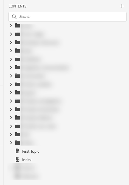

    So the HMTL5 output, by default, generates the index.htm file.  This serves as the parent frame and all topics are displayed within in it.  So when you have an html5 link, example: blah.com/index.htm#t=folder1%2Ffolder2%2Ftopic.htm, the index.htm is being called and the t= is the child topic loaded within it.
     The frameless output does not use the frames method, hence the name, so it does not generate an index.htm file by default.  That same topic's URL in the example above would read as  blah.com/folder1/folder2/topic.htm in frameless.

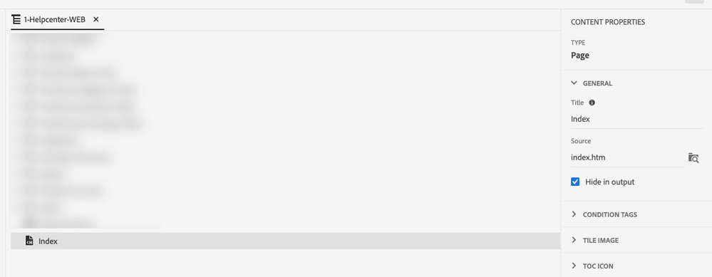

    So what you can do is create index.htm file at the root level of the Contents section (under the Author tab).  That will make the url for the page in blah.com/index.htm - the same link as frameless minus the child topic appended to the URL.
    Next, you would add the index topic to your web TOC.  After doing so, click on the index entry in the toc, and check the hide in output checkbox.  This will make it so that the index topic is included in the build but not listed in the TOC.
