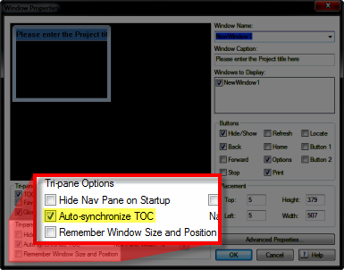

Hi there
Sounds like you need to enable synchronization.
You do this in the Window properties. (Project Set-up pod > Windows)
Cheers... Rick
Guest
Nov 04, 2012 Nov 04, 2012
It seems Auto-synchronize TOC already set in my window but this problem still not be resolved.
