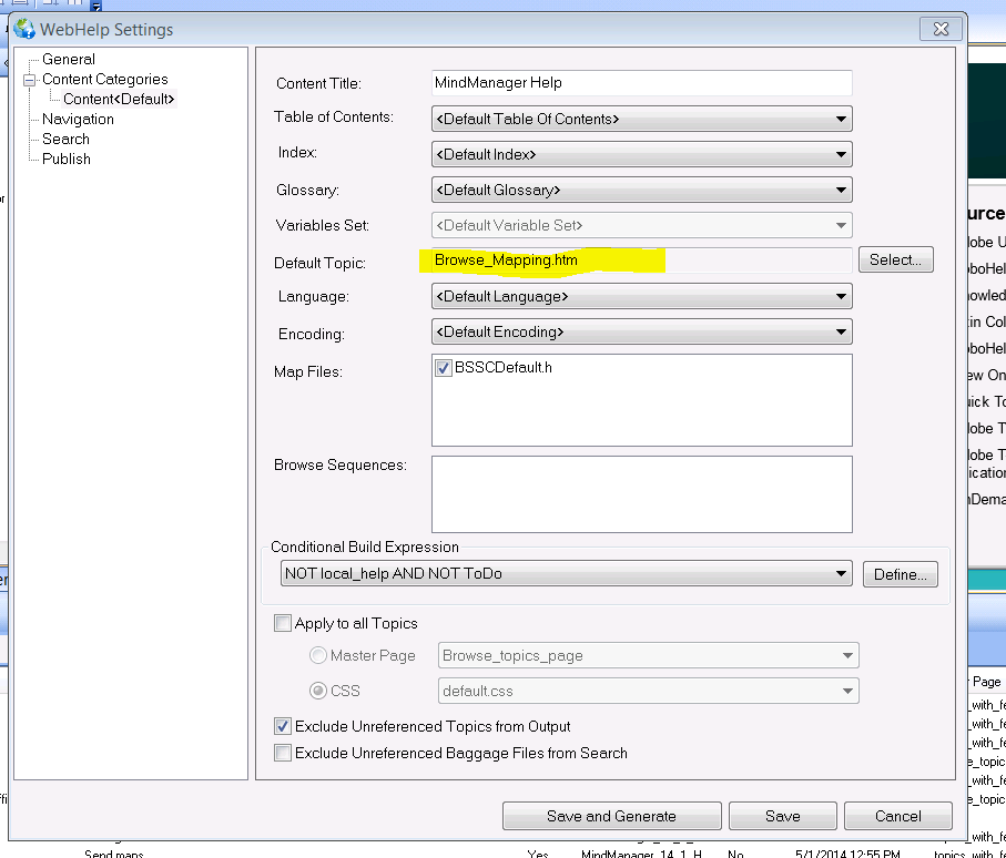

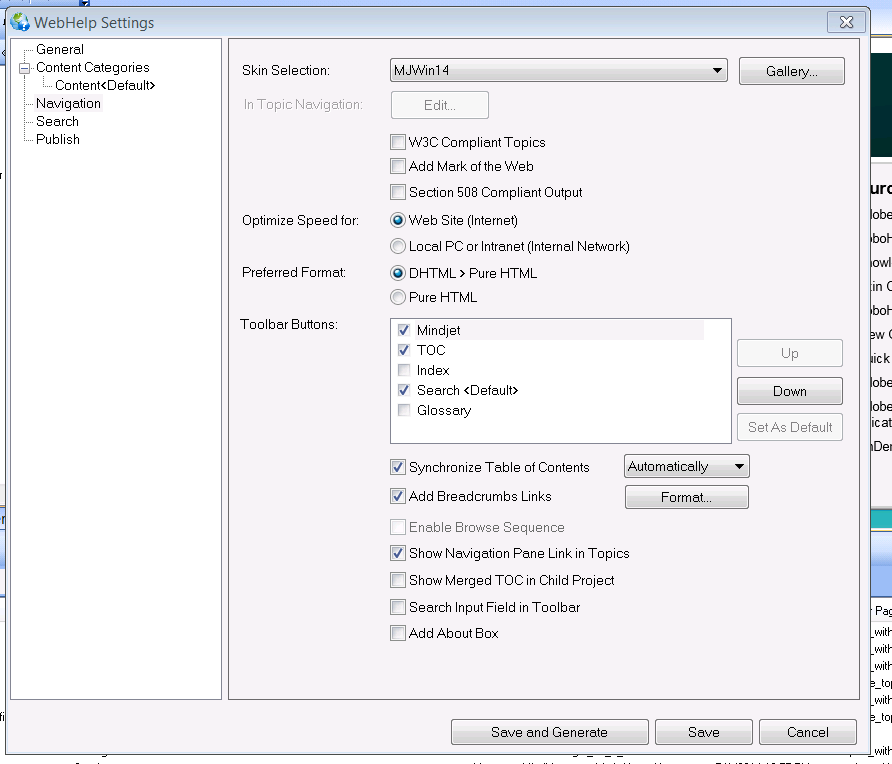

Take some screenshots of each of the Single Source Layouts for both the .chm and webhelp to guide us.

Okay, here you go:
I generate from one of two locations: the Remote Pro and the WebHelp to CHM Converter

Here's three captures from the Remote:
And three from the WebHelp for CHM SSL:
See anything?  In both, I highlighted that the topic I want Help to open as it's default is Browse_mapping.
May 08, 2014 May 08, 2014
Both appear to be the same – both are WebHelp outputs – I thought you said you were creating CHM help for your local and WebHelp for the online part?
What’s the issue with the default topic? I’m not seeing an issue with that.

@Rick – are you seeing any diffs then between the 2 SSLs?

When you generate WebHelp and you look at the Single Source Layout properties, you will see a path leading to the "WebHelp Start page". Normally, this page will be named Index.htm. So after you generate your WebHelp and you copy it to a server or wherever it will live, there will be a literal swarm of files and folders. But you need to open that Index.htm page. And at that point, WebHelp should open with the full WebHelp frameset loaded and you see the pretty skin. Toolbar buttons and all.
Now you have a topic named Browse_Mapping.htm. Because that topic is nominated to be the "Default", many novice users think that the path they should use to open the help would include pointing to this file. And what will happen if you do that is that you would ONLY see the content of this topic and no frameset or skin would show because you are pointing to a specific topic inside the help. And odds are, you would get a link in the upper left corner that the user would click to see the topic with the frameset (skin) surrounding it.
For context sensitive calls, one normally links to a specific topic within the help system. And that can happen in a variety of ways. If you are using the typical "Context Sensitive Help  or CSH" setup, you define map IDs in RoboHelp and you map them to the topics. And in the application, the developer issues some type of call that says "hey, i'm needing help and my ID is thus and such - and the API connects with the RoboHelp WebHelp output and assuming all is working well the correct topic opens.
