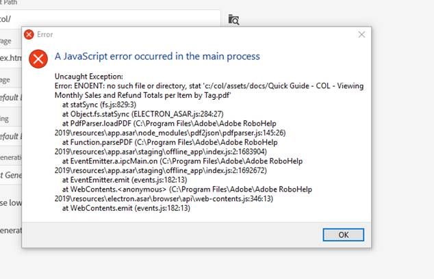

My project has a topic called “Library.” It has a little bit of explanatory type, and a bunch of links to pdfs. I had not added anything to this Topic for quite a while, and suddenly, when I tried to Generate Output, (after adding some content to a completely different Topic) I got this error.
Some of the pdfs were added by Importing the file into the docs folder. Some had been just dragged onto the page from File Explorer. I don’t know which method had been used on the file that blew up.
When that error appeared, there was no way to get out of it. Hitting Ok did nothing. The X in the upper right-hand corner did nothing. In order to get out of that page, I had to go to the Task Manager and kill RoboHelp.
I tried to delete just the file in question, and was given this message:
I couldn’t find any other project files where the offending file was referenced. So that’s when I brought out the sledge hammer. I deleted the entire Topic. There was no problem in doing so. (I’d been concerned that if the file really was being used somewhere else I wouldn’t be allowed to delete the Topic, but no issue showed up). Now I’m re-creating the Topic Library.
When I started recreating the Library, I started by making sure that the specific pdf that has been listed in the Java script error message was in the docs file, then dragged it out to the page to link to it. I then generated output. Everything worked fine.
For pdfs that aren’t already in the docs file, I’ve been adding pdfs them in. Then I drag the pdfs onto the page to link to them. I Generate Output after every couple of pdfs that I add. So far it’s worked.

As I understand it Node.js is effectively a local server to publish to. Sue was only generating at the point the error occurred. The only connection I can follow in that error is the use of the word "node" in the dialog. Have I missed something.
The updater process can only be triggered by going to Help > Check for Updates or by downloading the installer and running it. There is no way I can see that deleting a topic could initiate it.
The javascript error message is unlike anything I have seen.
None of the above though helps us solve the problem so here's what I would suggest to troubleshoot.
  1. Reboot the machine if not already done.
  2. Open 2019 and click the Help menu. About should read 2019.0.14. If it doesn't note the version that is applied before applying Update 14.
  3. Open the RoboHelp Reimagined sample project. It should be on the starter page but if it has been removed it can be found in Documents > My RoboHelp Projects.
  4. Import a PDF file into it and create a link from an existing topic.
  5. Generate that to a local folder.
That will either work as it should or show there is some general problem on Sue's machine.
If the above does work then try generating Sue's project again. I am assuming her project is on a local drive and she is generating to a local folder. If that is not the case, that should be tried.

@Peter Grainge I think Robohelp New UI is now written in javascript, which is how I managed to drag the Robohelp user interface into my topic in an early version of 2019 New UI and completely corrupt my topic (luckily I was testing, not using my real project, and Adobe fixed it real quick). 😄
@seang35269865 As you said, RH2019 New UI is new, so if the project has been updated through a number of versions of RH, then there might have been some odd html/css somewhere that cause New UI to get its knickers in a twist. Deleting the topic and starting again would probably have removed the offending code. I've seen all sorts of weird codes and invalid css and proprietary xml in the html code of RH topics over the years, so that's where I'm laying my bets.
