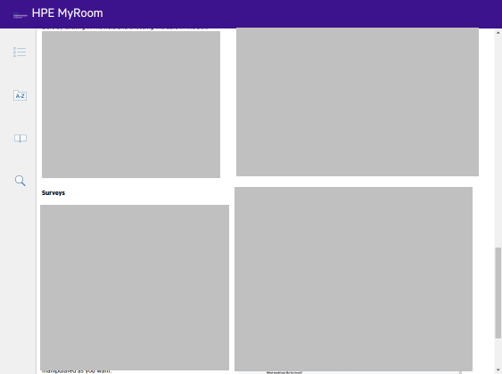

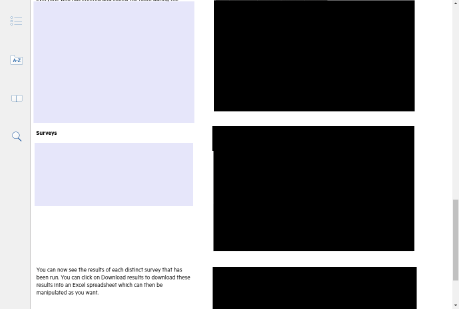

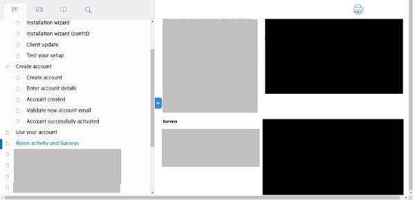

Yes, the screen layout completely changes as the window is resized. In the first picture attached, if I pull the window wide enough or go full screen, a second interior scrollbar appears and that one works.
However, as in the second picture, if I make the screen smaller so the TOC collapses and the tabs shift to the left instead of on top, the inside scrollbar disappears and the outer one is non-functional.
Then if I expand the window again and the TOC expands with tabs back up above, the inside scrollbar does not reappear, I have to go to the next page that is longer than the window for it to reappear. Hence, as far as I'm seeing it, the responsive nature as you explain above is not functioning properly.
