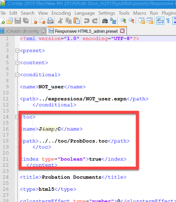

I did some more digging. I have two presets for this help file (one for the admin and one for the users). This is what I found
When I viewed the preset in the GUI it showed it was picking the toc ProbDocs but the html file is showing <name>J&amp;C<name>. The path is correct. I will manually change this and see what happens. Is there another place I should be checking for the TOC name?

Maybe the best thing to do would be create a new, not duplicate, preset.

2. In that one file I found other files that RH2019 must of named for me with J&C in it. I was able to rename those manually. Also since you said there were many updates to the TOC, I went through the TOC very detailedly and found areas where I forgot to change J&C to Prob Docs. So basically I looked at EVERYTHING.
3. I did delete my 2 presets I had and recreated from scratch like you said.
4. After all that, no change. I received the same error message.
