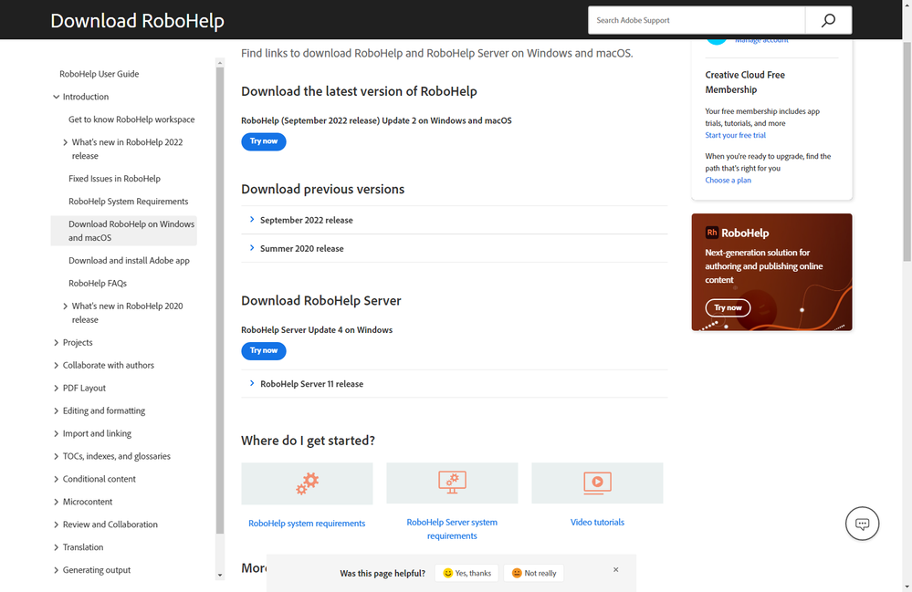

As for uninstalling/reinstalling, where can I find the 2019 Classic installer? I can't find it on the Download RoboHelp page.
