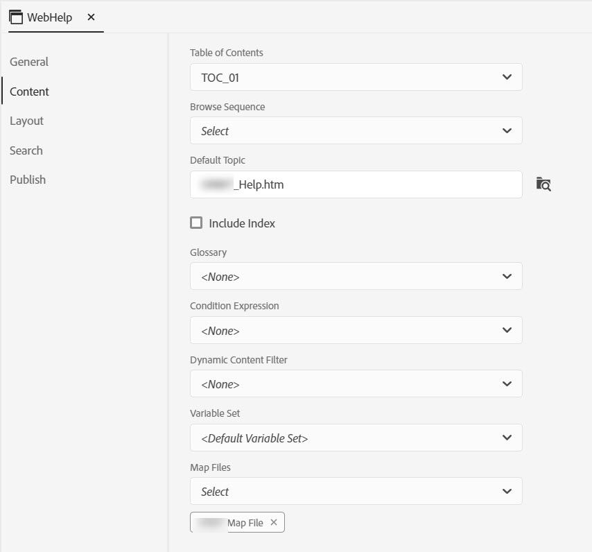

Please add a screenshot of your Output Presets using the photo icon above where you reply.
Open the properties and try selecting a different skin.

Community Beginner ,
Jul 16, 2020 Jul 16, 2020
Copy link to clipboard
Copied
Hi Peter,
Here are the screenshots. I selected a different skin but got the same issue.
Copied
Thanks for your suggestions Jef & Peter. Earlier I was using a duplicated preset. Now I have created a new preset but the issue still persists. 😞
Screenshots of new preset
