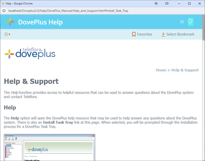

Here's an example of what is returning with the URL:
 http://localhost/Doveplus2.0/help/DovePlus_Manual/Help_and_Support.htm#Install_Task_Tray
This is the top of the Help & Support topic, the Install Task Tray section is further down the page.
