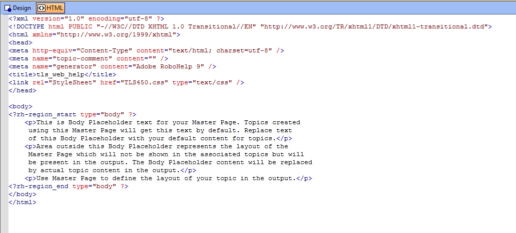

I just noticed that when I create a new topic, I see this unusual local formatting <p class="TABELBODY"> tag in HTML view (see below, 4rth line from bottom). This is where the mysterious "TABLEBODY" formatting is originating that I've been plagued throughout my current project.

I decided to open up a new topic using my other master page, and also noticed strange tags in it  (<?rh-region_start type="body" ?> ). See below, 3rd and 12th lines from bottom.
Consequently, I finally figured out that both my master pages had junk HTML tags in them, which carried over to all of my topics. I have now fixed the master pages by editing out the junk in the HTML mode.
I did some further investigation and found out that the originating project that was the basis for my current project also had master pages with the same tag issues. So now I'm wondering, how did this start? Maybe someone imported a RH html output file into a project by mistake a long time ago, and it corrupted the master pages right up until this time? Or, could it have been from upgrading from RH 7 to 9?

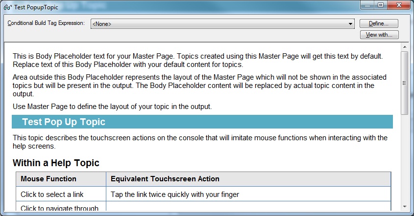

I made the minor edits on my two master pages to get rid of the junk tags shown above and did a Save All. Here is the result (see screens below):
Master Page 1 After Edits
Master Page 2 After Edits
That's ALL I touched. However, now when I view any topic using these master pages with either the Preview mode (eyeglass icon) or as a final output file, the default text from those master pages displays on top of the topic. Interestingly enough, the master page text does NOT display in these topics in Design mode.

Update - I restored my two master page files from yesterday's backup (xxxxxx1.htt and xxxxx2.htt) and the topics are back viewing normally again. However, I still have the "junk" html code in them.
Any one know what value this "junk" code brings to RH, and how I can remove it without messing up the browser display of my topics?
