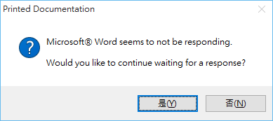

Hi! I am now using RoboHelp 2015 and I encountered the same problem (unable to generate printed document). Though I've tried the above-mentioned workarounds, regretfully none of them can solve the problem.
The MS Office I installed on my laptop is 32-bit Office 2013 and the laptop (a brand-new HP laptop with i7 CPU, 16GB RAM, and 4GB independent display card) runs on Windows 10 (by default).
I also placed some screen captures below to show the error messages I got when encountering the problem. Meanwhile, I've contacted Adobe Support to report this bug.
David

I'm sorry but this thread contains pretty much all the answers known to humankind.
I don't know of any others so unless someone else has a trick to add, I think the answer has to be Adobe Tech Support.
